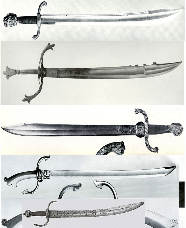

PostPosted: Wed 29 Jun, 2005 8:02 pm    Post subject:         Reply with quote
The deep fuller pattern close to the back edge (possibly lingering remnants from single edged viking swords and hun sabers) could lead someone to interpret it as a double edge especially with the shading in the picture Nathan posted... However, I have never seen a double edged Falchion.
ks
 Attachment: 88.86 KB
One from Hermann Historica the rest from "Armi Bianchi Italiane"
Two swords

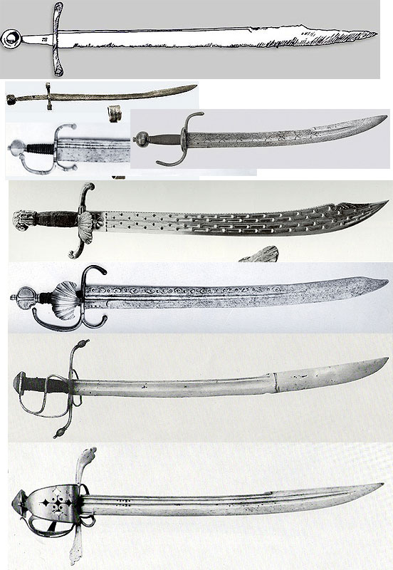

Alex Oster wrote:
Its so strange to me to see the way falchions are embeleshed. Were they primarally a late period Italian sword? I guess I am drawing a blank on the specifics.
Hi Alex...
Probably not the best person on specifics here...
However, I have always thought of a falchion as more of a blade type than a sword type. The clipped point blade seems to appear on many hilt styles. The Italian versions seem to be one of its most fancy incarnations.
ks
 Attachment: 96.93 KB
Hermann Historika, Oakeshott and “Armi Bianche Italiane”
Two swords
Lit in Eden’s flame
One of iron and one of ink
To place within a bloody hand
One of God or one of man
Our souls to one of
Two eternities
PostPosted: Fri 01 Jul, 2005 1:11 pm    Post subject:         Reply with quote
It's worth noting to avoid confusion that not all those shown above are falchions. The last two, in particular, are better called dussack, dussage, or even saber. They certainly do show similar types of blades, though, and give an impression of the shapes that were present throughout history.
