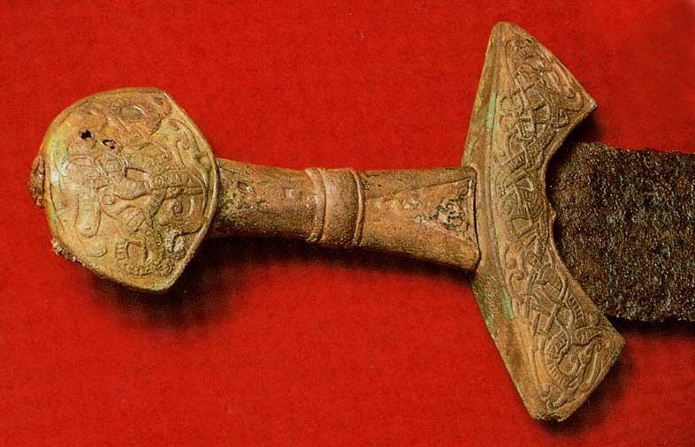

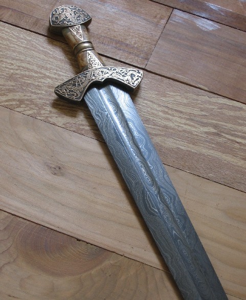

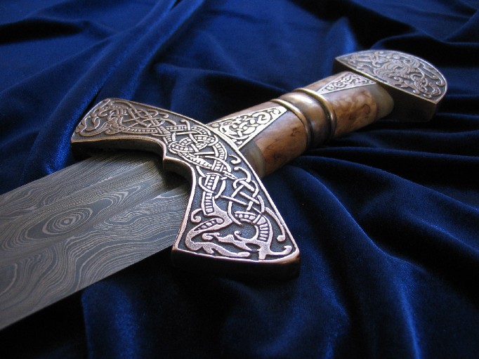

I was approached around a year ago to make an interpretation of the Finnish Princess Sword,using a Damascus steel blade and with attention to detail on the grip.I am aware that Albion will be producing their version,but i think i am right in saying that they will be fitting a bound grip rather than the style of the original,so hopefully no toes stepped on Big Grin
I have used horn and Masur birch for the grip,with inset bronze panels and a bronze central ring,to reflect the original look which appears to be carved bone.
This is really an ongoing project,as i have made patterns for scabbard mounts that will compliment the sword fittings very nicely.This Sword is at present rough assembled to give you an idea of the eventual dynamics of the piece,the fuller extends to around 3" from the tip,it really has a very elegant and beautiful look to the piece as it stands,i may also make the scabbard in Birch for a nice matching set.
I need to invest in a tripod so that i can get some better shots,but i will try and keep this updated as things progress.

oh wow Surprised that is beautiful.
I am simply amazed and it isn't even finished (no pun intended) yet.

WOW! Breathtaking sword! I realy like the engravings on the hilt and the finish on the blade!

Beautiful sword, I'm interested in learning more about that original which is amazing as well, seems in quite good condition. Why do they call it the "princess" sword, was it found buried with a female skeleton?

The sword was found in a grave near the village of Suontaka, Finland. In the grave there were some other weapons and a female skeleton in an armour. The grave and the remains have been dated to about 1000 ad. The remains were found while digging routes for water lines back in 1968.

I do love pattern welded blades, and this one seems especially beautiful! Well done Happy

Thank you all so very much, I am very happy that this project has received such a favourable response,the original is such an extraordinary Sword,unlike anything else from the time period that i know of,it deserves a thoughtful approach in the interpretation,I look forward to finishing the scabbard too.

Can you tell me a bit about the metalurgical composition of the blade? The patterns look a bit like there is some nickel (?) in there?
How much does the sword weigh and what are it's dimensions?

the sword weighs in at 2Lb 14oz
2" wide at the cross
7/8" @ 2" from tip
P.O.B 5"
the steel composition is 5160 and 203E, a high nickel mild steel alloy.
