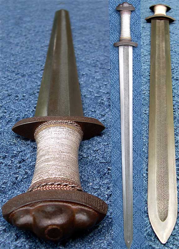

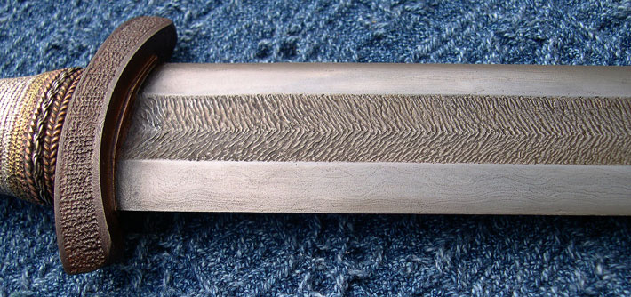

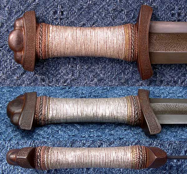

Hey guys… (and gals)
I got a really good deal on a used Godfred Viking Sword last year. Some how I got a dark stain in the fuller and when I tried to rub it out I inadvertently botched the etching in that area. That set me off on a long series of redos…
The Blade:
First I reshaped the tip and ground away the secondary bevel, giving the edge geometry a smooth "appleseed" section. Then I took my die grinder and ground out the end of the fuller to match the geometry of the tip. After that, I used the diamond bit on my dremel tool and tried to change the etched “Damascus” in the fuller into a more authentic pattern welded look. Then I etched the whole blade to bring out the folded pattern, especially along the edges. Finally I coated the whole thing in mustard for about 20 minutes, wiped it off, let it darken over night and then lightened it all to a bluish gray with steel wool.
The Pommel and Guards:
I re-etched the guards and pommel to give a more topographic effect… But then I didn’t like the thickness of the upper and lower guard, so I ground the etching off and continued to grind away until I got a more authentic “boat” shape. With a diamond bit in my dremel, I cut a dot-like pattern in the center of the upper and lower guard and then re-etched to give a topographic effect. Finally I applied many coats of cold browning solution let it rust and then applied a thick coat of oil.
The Grip:
The grip was another comedy of errors. First I stabilize the original Godfred leather binding with super glue and tried to grind it down… No luck... it flaked off… So I stripped off all the leather and ground down the wood core. Then I covered the grip in leather… but I didn’t like it so I ripped it all off too. Then I remembered those period accounts in the sagas that speak of sword hilts “bound in silver.” I decided to buy some silver wire and wrap the grip. I used twisted copper with bronze and brass wire near the guards in an attempt to visually shorten the overlong Grip.
And now it is finished... Well as finished as any of my swords will ever be Happy
Here are the stats…
Weight: 2 pounds 1 ounce
Overall Length: 34.9 inches
Blade Length: 28.75 inches
Blade Width: 1.9 inches
Fuller: 0.75 inches
Guard Width: 3.5 inches
Grip & Pommel: 5.5 inches
Grip Length: 4.4 inches
Point of Balance: 4.3 inches from guard
Center of Percussion: 18 inches from guard
I have attached a few pictures…

By the way, what size of wire do you use and how do you twist it? While I can't be sure, it looks like you have two different types of "twist"(?) -- I have tried, but it always looks very uneven.

Wire twisting: I've had good, even and fast results by inserting a bent piece of metal coathanger in my electric drill socket, doubling a single strand of wire and securing one end of the loop around a nail in my workbench, the other in the crook of the coathanger/bit, then just running the drill. Beading wire from the craft store is fine if you don't want antiqued effects. It's tough to find plain steel wire in different sizes, though. Home improvement stores sell little rolls of plain, blackened steel wire of around 18 gauge. It's a bit too thick for creating twisted strands.

I believe the wire was about 20 gauge...
Somewhere between 1 and 1.5 millimeters in diameter. The copper wire I bought from the local hardware store and just stripped off the plastic coating. Make sure you get solid copper wire and not the fine twisted kind.
The bronze, brass and silver I bought off the internet.
Learning to twist the wire was interesting.
I started by taking a single strand of wire putting one end in the vise and the other end in my electric drill...
I began twisting it slowly thinking it would twist into nice even kinks. No luck, it just got thinner and broke.
So I slept on it... and realized that it is not "twisted wire" it is "twisted wires" Dah....
So I took a long piece of copper wire about 6 foot long and bent it in the middle with two strands about three feet long...
I put the bent end into the vise. I bent over the other two loose ends and forced them into the chuck on my electric drill and tightened it down as much as I could. I then held it very taunt and very slowly let the drill twist the two wires together. I twisted them to the point where it broke.
I then repeated the process but this time I set the direction of the drill in the opposite direction. When you lay these two twist wire next to each other it creates a beautiful herringbone pattern often seen inlayed into the hilts of Viking swords.
The trick to getting an even twist is to go slow and even on the power and keep it taunt. To get the same degree of twist I would hold the first twisted wire next to the second as it is forming and stop when they match.
I experimented using three strands one of bronze one brass and one copper... it looked like a series of beads... a little too busy for my taste.
I also tried using copper wires of different diameters... it looks really nice but not sure how authentic it would be on migration or viking era swords.
As for different types of twists... It might appear that way because I have ground off the herring bone sets closest to the silver wire. I did that to try to play down the decorative ends to the grip... It seems a bit too much. I you check the link to the home improvements forum on SFI given in my first post you can see the other herringbone sets before I ground them down. Also the silver wire is not twisted it is simply wrapped around the grip and epoxied in place. I roughed it up a little after I finished and it made it look as though it were twisted.
Thanks for the kind words on the Godfred.

LOL! I had exactly the same first experience with the twisted wire. Thinner, thinner, thinner...SNAP! Slept on it and figured it out. I bet you rolled your eyes and smacked your forehead, too, when you saw the solution. Other epiphanies:
• The amount of wire needed for a twisted wire grip is astonishing, not to mention the amount of linear physical space required to twist a strand long enough for a grip.
• Like you, I found that the trickiest part of the herringbone is getting the identical amount of twisting in the second set of strands so that the "peaks" of the strands match. I did exactly as you did, using the first strand as a guage.
Still, you get a lot of bang for your buck with this technique, and it's actually kind of fun. If I could tie a Turk's Head knot, I'd make a wire grip for my 17th c. replica.
