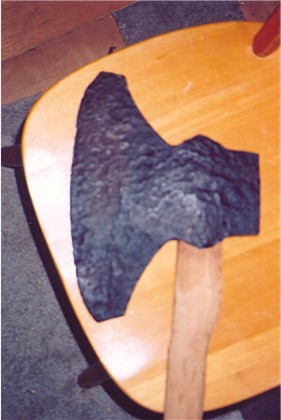

Don't mean to rob your thread, but since your on the subject of axes,etc. I found this monster under an old building of my grandmothers probably 35 yrs ago, stuck a homemade hickory handle that my grandfather use to make on it and it's just been lying around ever since. Have been told it's probably from the early 1800's. Anybody else have a clue?
All I know is that it's old & heavy as crap.

PostPosted: Wed 09 Mar, 2005 7:21 pm    Post subject:         Reply with quote
Hijack away, brother! For once I can provide a definitiveanswer instead of more questions and speculation. Laughing Out Loud
What you have there is a (very cool) classic early American broad axe. Here's the relevant section from Eric Sloane's A Museum of Early American Tools
 Attachment: 106.62 KB

I was hoping to get a legible scan for you, Bill, but my machine is suddenly imploding. I'll try again tomorrow evening. The gist of the text is that this axe is for shaping timbers rather than felling trees. It has that big poll and short, offset handle because it's held in place and whacked to square the edges of beams.
