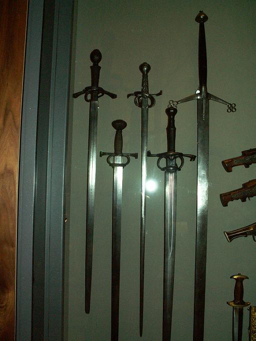

I think Dan means the one in this pic:

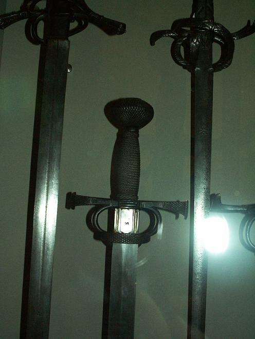

The swords in this next pic might also help:

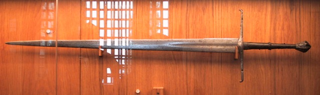

The blade, maybe a little less wide near the guard?
Your blade so, is similar to another sword. The famous "Lupa" (she-wolf" of Brescia.) (different period)
Will I see her everywhere. In love with her. We are made one for the other.
Stuff to be examined by a psychologist. Razz Big Grin Cool

Thanks for the photo tips, Dan and Greg! I'd take every sword in that case. The one y'all are noticing is too complex for my meager skills but it is beautiful.

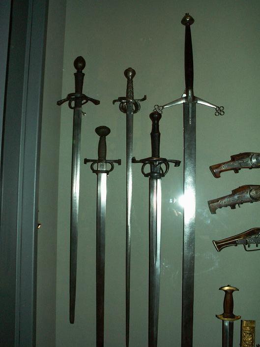

I just remembered another photo I had of a pair of swords that might help shape your image for this project.

Greg, that one you posted looks a lot like (if not identical to) one re-created by Peter Johnsson for the Royal Armoury in Stockholm. Do you know where it is located....perhaps it is the original?

This case was unmarked and in the children's section--which at first made me think these were not authentic but replicas or something--of the Royal Armoury in Stockholm. So I suppose this is either the original or Peter's recreation.

That sword is mine *and* it is the original (they are one and the same) Happy
I was asked to make a sword for the Royal Armouries to use for their knighting of children during various festivals and open house events.
The theme of the project was the romance of the knightly ideals of the early 17th C. There were tourneys and festivities celebrating ancient/medieval times at that time.
There are swords surviving from this period that show a romantic mix of old elements with the contemporary. I think the illustrations that have inspired Sean Flynt´s project is an expression of the same thing: not necessarily depicting specific or popular sword types, but drawing Swords with an archetypical or classic flavor. A way to build a credibility of having support from ancient times, or re establishing old arts. That is the spirit of the renaissance after all...
I presented half a dozen different suggestions to a design that would be in this spirit: a sword of the early 17th C that would celebrate the ideals of older times. This design was the favorite and it was fun to make.
I have seen some swords that were made like this. There is one in the Wallace collection that is a very god example. It looks like a very big left hand dagger. An italian blade. I shall see if I can dig out the catalogue number. It is not depicted in the printed catalogue. I do not know how much they have advanced with internet publishing of the new photos of all th objects in the collection?
It is fun seeing my old sword. It must now be ten years old or more.
It starts to look almost genuine! Razz
On the left is A&A´s replica of the rapier of Gustav Wasa.

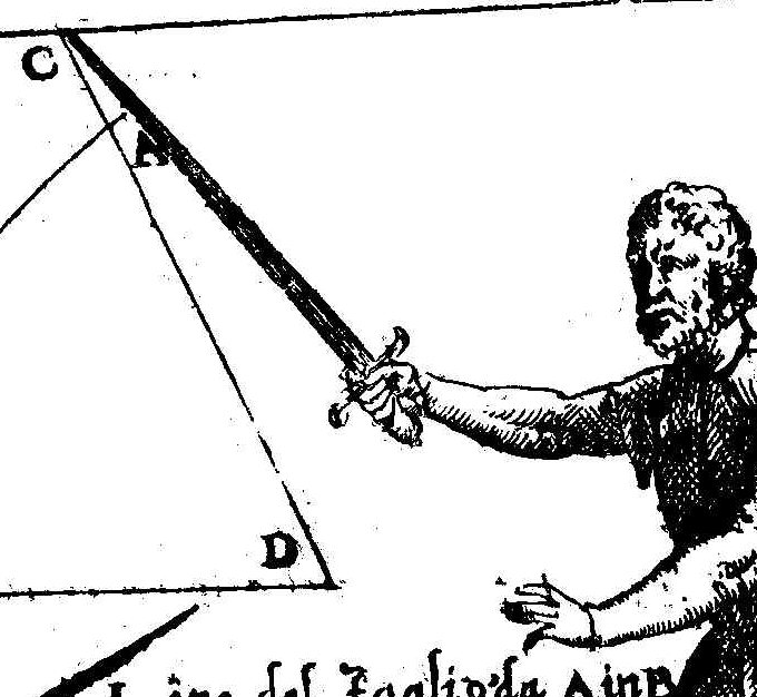

A detail from Carpaccio, ca. 1500. Note sword length and acutely tapering profile.
 Attachment: 173.58 KB

PostPosted: Fri 12 Mar, 2010 7:54 pm    Post subject:         Reply with quote
A bit, but it helps to see an antecedent, get some idea how the type might have developed...

Sean, I have seen Italian painitngs from the same period depicting swords with böades just like that and hilts of the same type I used for Albion´s "Machiavelli". A few even with knuckle bow as well. I am not sure I saw one with just a single front ring over the cross.
The type does exist, naturally.
Norman, in his "The Rapier and the Small-sword" gives this type # 10. and dates it to 1510 to 1650.
He says:
"In most areas of Europe the side ring is oval, but in German lands, however, and in areas under German influence, such as Scandinavia, each end of the ring, which is roughly U-shaped, turns outwards towards the ends of the quillon and is often decorated with a simple but effective dragon head.
The first illustration I know of a side-ring mounted on the quillons without other guards is the engraving by Daniel Hopfer, believed to be f Kondrad von der Rosen about 1515.
And he goes on mentionng other diepictions in art.
He also mentions some surviving swords with hilt of this type, but they are not common. The swords mentioned are of rather prestigious use.
