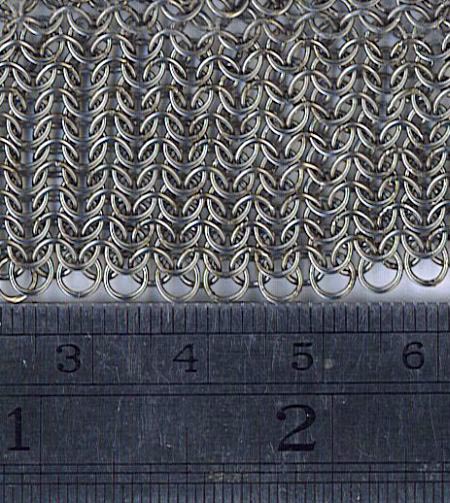

While not riveted, there are machines which produce welded maille, for use in shark suits, butcher's gloves, auto convertible roof liners, and fashionwear/jewelry. Whiting & Davis is the most well known, although I believe Niroflex is also in the business. Last I had heard W&D were the only ones in the world who owned the patented machines for making the mesh, though if things have changed since I cannot say.
The attached image is a scan from a sample of Whiting &Davis maille I have, just to give you an idea of how tight this stuff is - it feels very much like fabric.

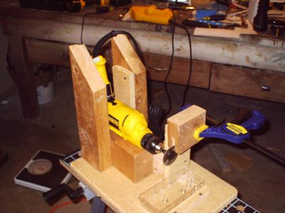

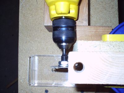

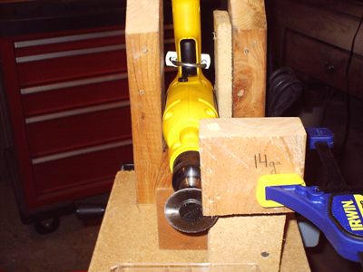

Figured I would throw in my method(s) as well. I've been making maille for a number of years now, more as a hobby then anything else. I started out with a set of aviation snips but just never seemed to have much luck with them. From there I moved up to a set of bolt cutters that have worked well for several years. Like a few others mentioned you can make a pretty effecient setup with a table vise or by screwing one handle to a table. Slide a bar over the other handle for some added leverage and you can cut several rings at a time.
I had tried using the Dremel cut-off wheels but either burnt through a lot of wheels or removed too much material when cutting. So at a friend's suggestion he pointed me to another site where I found a picture and some information about a tool someone had created to cut rings. A Friday night of drafting and a Saturday afternoon of construction yielded me this nice jig.
The blade is a HSS Jewelers that are real cheap to pick up and replace. Currently I just wax the blade between cuts, but I'm working on (and almost finished) a slow oil-drip to keep the blade lubricated. The little basin underneath can be swapped out for a piece of angle aluminum that acts like a chute and leads off to a 5 gallon paint pail for when I'm cutting a lot of rings.
Credit for the design certainly goes to the original inventor.
~Dominic
 Attachment: 23.39 KB
Overall picture of the jig. You can see that the block is held on by a clamp. I have blocks cut for various diamters and gauges of wire and just swap them out depending on what I'm cutting.
 Attachment: 22.13 KB
Front view. The block here is for 14ga 5/16" diameter rings. You can see a clamp on the trigger which means the drill is always on. I have a control switch mounted on the back that turns the whole unit on and off. Avoids me having to reach my hand in
 Attachment: 21.45 KB
Top down view with the catch basin below. Have to make sure that the blade comes in far enough to cut fully through the ring but not the other side
