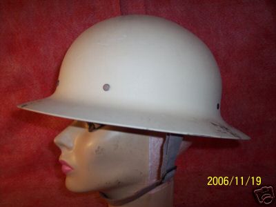

I have an old civil defense helmet of the type shown below (photo from a current ebay auction). I'd rather have a mid-late 15th c. "kettle" type infantry helmet. In theory, I just need to strip the paint down to the bare, bright steel and make a new liner and chin strap to convert one to the other. But would the overall form be appropriate for the period? All I'm seeing are the type with reinforced bowls and separate brims. Seems like the one-piece design of the CD helmet would be simpler, if not necessarily as strong. Before I proceed, I need to see some good examples of the 15th c. helmet type. Does anybody know of such--antiques, artwork or repros? I've seen the BestArmour kettlehats and sifted through the fora here, but no luck yet. Period artwork is especially welcome. If the form won't work for this period, but would for a later period, I'd like to know that as well. Any advice?

PostPosted: Mon 11 Dec, 2006 8:50 am    Post subject:         Reply with quote
Try here
http://www.bagrit.pl/artykuly/artykuly.php?ar...25&k=1
http://www.bagrit.pl/artykuly/artykuly.php?ar...00&k=1 second part-unfortunately in polish...
there are some drowings that may help
In my opinion 15century kettle hats had different bell shapes than civil defense helmet...(for egzample central 'rib' )

PostPosted: Mon 11 Dec, 2006 9:02 am    Post subject:         Reply with quote
Great resources, Michal! Thanks!
This one actually isn't too far removed (for my use, anyway).

Oh yes-this one can be made..probably.Maybe several hits with hammer and that nice top will appear ...but you have to ask someone experienced with armour making.

PostPosted: Mon 11 Dec, 2006 11:22 am    Post subject:         Reply with quote
CD helms are pressed to shape so the metal is easy to tear open if you work it cold, best thing to do is hammer it hot if you can. There is a fellow I know who cut the brim off, added a center ridge, added large roundels, and added neck scales to look just like some helmets you see in King Rene's book or tournement.

PostPosted: Mon 11 Dec, 2006 2:01 pm    Post subject: Re: Need project advice--medieval helmet         Reply with quote
Thanks!
No cold working, you have to anneal it <(soften) heating it for quite some time on a forge, than you can start some hot and cold working.
Better hot.
PostPosted: Mon 11 Dec, 2006 2:26 pm    Post subject:         Reply with quote
If I do this at all, I won't do any working of the metal apart from drilling holes for the new lining/rivets. I just want to get as close to an original design as, say, MRL does with its helmets. This would just be a shelf piece--a way to get this helmet out of a box and on display.

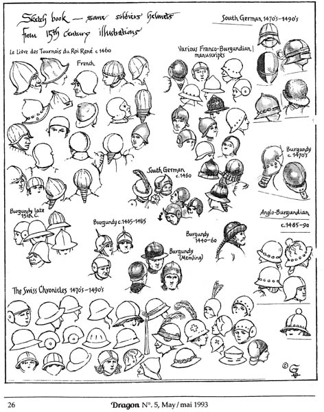

Another thread on this subject turned up this very helpful illustration from the Companie of St. George. Full text of Dragon #5 is here: http://www.companie-of-st-george.ch/dragon-5.pdf

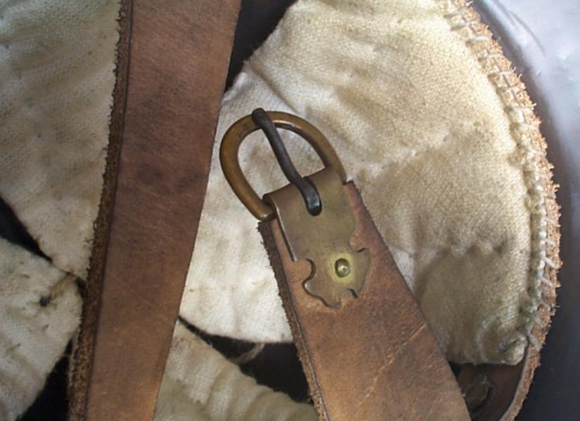

When I finally get around to this project, I'll just use Citrus Strip and a sanding sponge (hopefully that's all it'll take). Then I'll make a new band and liner from a Goodwill belt and chamois. Nails for rivets. Remains of the belt will serve as chin strap, as in the illustration above. Might make a simple buckle like the one shown below. I want the piece to look good, but I'm not a stitch counter. This is going to sit on a shelf until my son, due in August, has a head and imagination big enough to wear it years from now.

That's the look I'm aiming for. Judging from the CSG's helmet illustrations shown above, I'm guessing this would be Burgundian, late 15th c. The CSG site is amazing, by the way. Don't miss it. http://www.companie-of-st-george.ch/index_1.phtml
