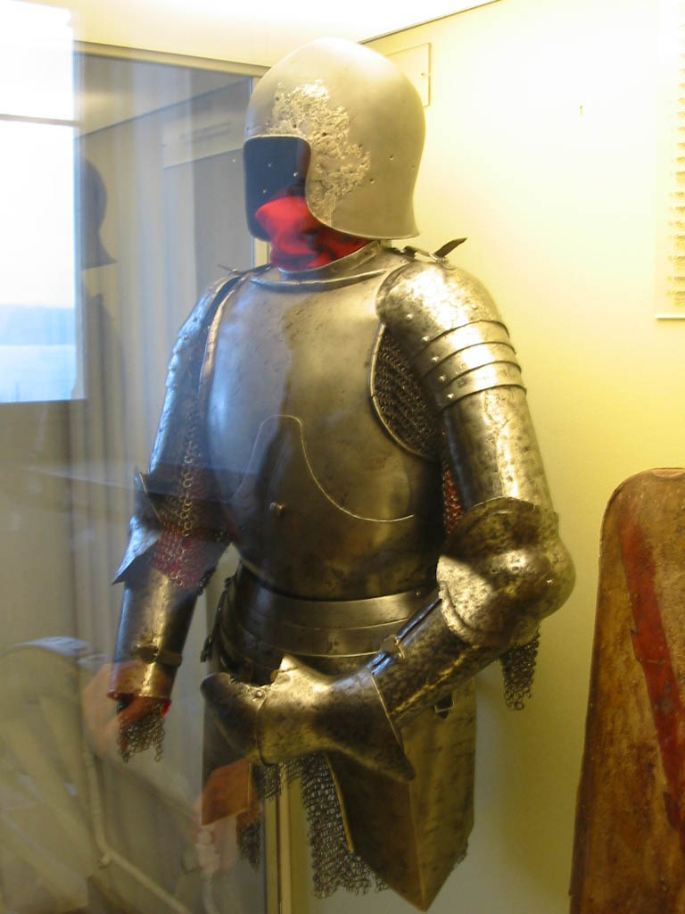

Thought id add a picture of a munitions harness with similar surface as in the artwork;
And if anyone wants to contribute with photos of munitions-grade leg armour that would be interesting as well.

That's a very nice shot, W. Thanks for posting it. You're right--the surface is very similar to that shown in the painting. I can't help but laugh at the helmet, though. Now that is reconstruction! Laughing Out Loud Maybe there's more of the original on the right side.
