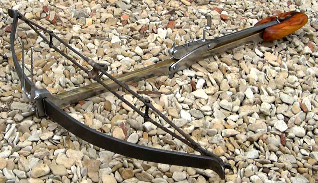

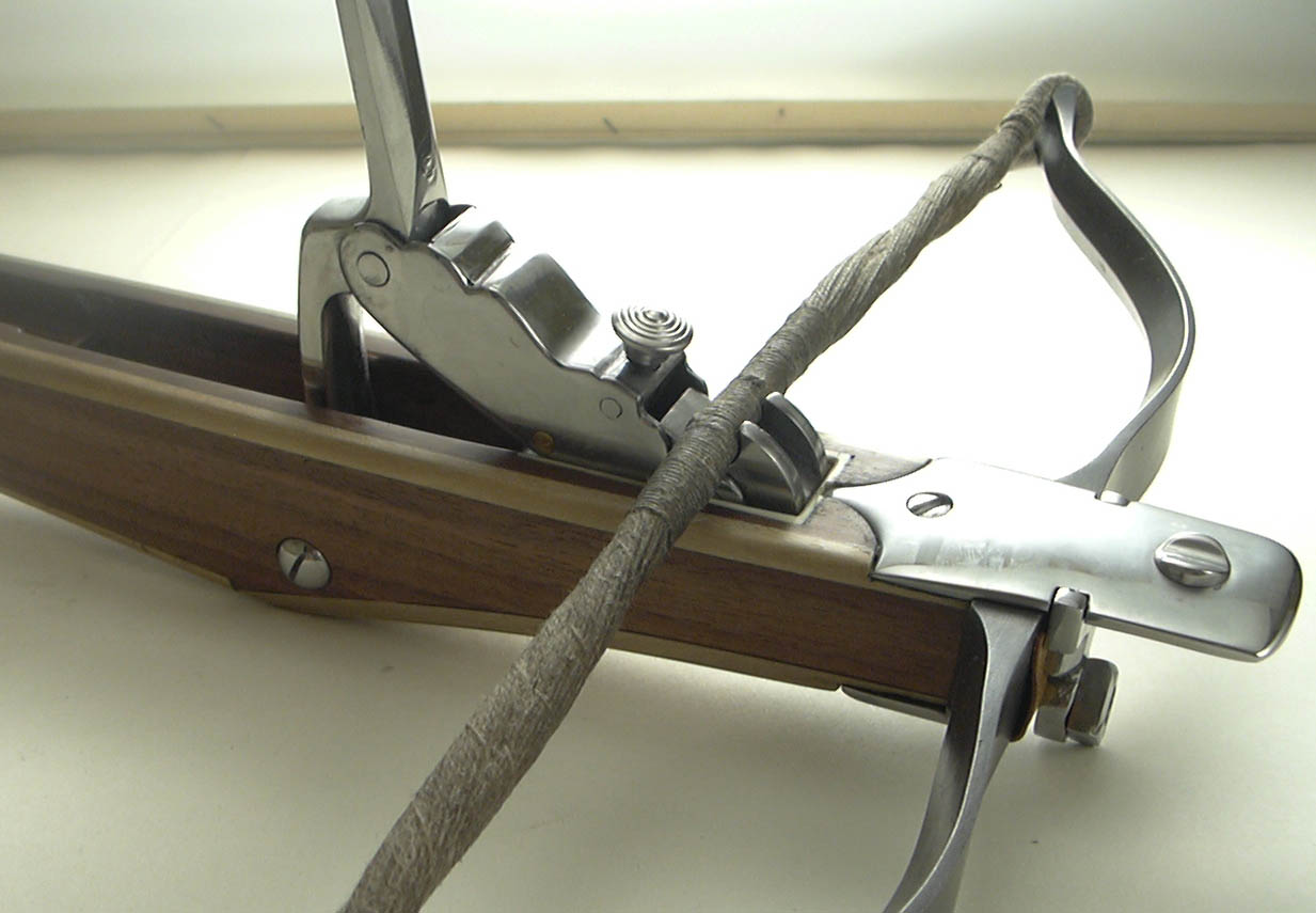

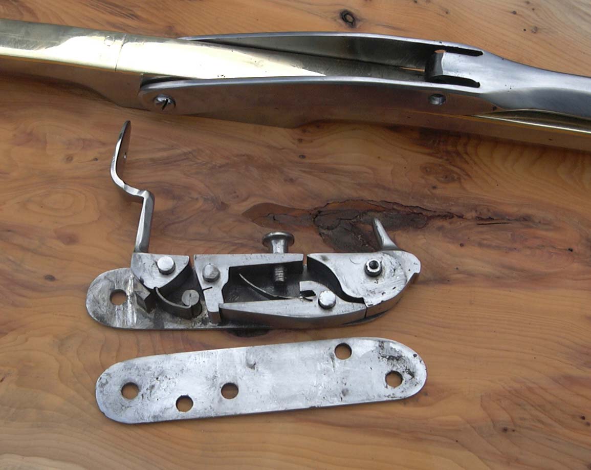

Posted: Sun 25 Nov, 2007 9:40 pm Post subject: latchet bows and mechanisms |
This is an old thread........I had the luck to handle and original latchet bow about 2 years back that a collector had brought over to show me I took one look as did a customer of mine I was with and that was that. You will find reasonable pictures on my crossbows page and on the gallery page where the mechanism is shown quite well. These pictures were not up when this thread was originally posted.
The button on top replaces the lever usually found in conventional trigger mechanisms, but otherwise the set up is the same, this is exactly how the original was set up. It treads a very fine line between too hard to push and hair trigger and I suspect that a little wear will make it need an adjustment, but like I said, just like the original.
I have since made a button push trigger mech on a 17th C stonebow and this has superficially similar looking trigger set up except it has an extra sear in the train and this makes the release far better, this set up was taken from Payne Gallwey for the stonebow.
It was a lovely little comission to make and I was very pleased with the outcome. It drew in the order of 250llb, shot proper tapered bolts with hand forged heads about 8" long, the prod was 14" tip to tip with a linen string. The trigger mechanism was built into the cocking lever so you released the lever, ran the trigger block forward, it picked up the string, pushed the lever down where it locked into place, seat the bolt and you were ready to go.
A shot every 10 seconds was easy (although not tried on horseback) and with small bolts and 250llb power was not an issue - I never tried an ultimate range but I would guess at 140yds. It may have been small, but without doubt a fomidible weapon. I will try and post some pictures but I usually fail at this point.
Tod

Posted: Mon 26 Nov, 2007 10:08 am Post subject: |
Leo;
Very interesting design and at 250 pounds of draw it's not " puny " but it does look smaller than another crossbow shown next to it: It does seem like the point was to have a fairly compact weapon of adequate power.
It does seem based on the goat's foot lever principle but integrated into a single cocking/crossbow mechanism of some complexity i.e. Not a cheap crossbow I would imagine and needing a lot of skill to make.
Were some of these made in heavier draws for war crossbows ? I would think it would have been a great idea to arm a troop of crossbowmen with these unless the cost per unit was extremely high ? Well a very rich high noblemen could have afforded them for a small personal guard or elite force.
I'm assuming that these are fairly late period crossbows and would have been mostly hunting weapons as crossbows were generally being replaced by archebuses early in the late 15th and early 16th centuries.
So, apart from hunting, would these be used as home defence weapons or coach " crossbows " in the sense of later blunderbusses or having a poleaxe next to the door for use against unwelcomed " guest " ?
Posted: Mon 26 Nov, 2007 11:19 am Post subject: |
If these were, in fact, favored by Borders horsemen, I can guess several reasons that might be.
• The Borderers wore minimal armour, so the pistols favored by the better-armoured cavalry of the period might not have been as necessary.
• The average latch may have been cheaper to produce compared to the average pistol. Even the wonderful example shown here is mechanically simpler than a wheellock mechanism. Interestingly, the latch mechanism shown here seems to be at least as complex as a snaphaunce, but avoids the difficulties of barrel-making. Still, I can see that somebody would pay more for a quality latch than they would for a mediocre pistol.
• The latch would have a much higher rate of fire compared to a pistol.
• The latch might be loaded at full gallop by a horseman as experienced as the Borderers were known to be. I can't even imagine trying to load a pistol in those circumstances.
• I would guess that its lethality at common ranges of engagement would compare favorably to a pistol.
• In theory, one could make field expedient projectiles when proper ammunition was not available, whereas one needs at least powder for a pistol. On the other hand, quality latch ammunition would be much more labor and time intensive than equivalent pistol ammunition.

Leo Todeschini
Posted: Mon 26 Nov, 2007 6:32 pm Post subject: |
This has to be a quick post I am afraid.
I have never come across this mechanism for war bows as such, maybe some did and I could easily see it being able to draw 4-500 with a upscaled version. I am a little sketchy as to the date but yes they seem to be about when wheel locks were. The short stock and top trigger mean to me that this was a close quarter weapon rather than an aimed one as such, but at 10 yds or so I wouldn't stand up thats for sure.
It was wrench to sell it though cos it was fun.
Tod
