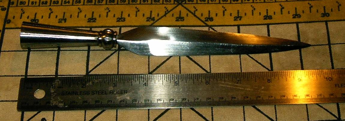

So from the descriptions it sounds like something more along the lines of MRL's Hewing Spear head with some minor tweaks woudl be appropriate. Sound about Right?
Attachment: 11.18 KB
MRL's Hewing Spear
Attachment: 95.01 KB
New Pike Heads our group purchased [ Download ]

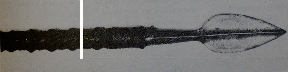

Have you seen these images? They're from the very nice book The English Civil War, 1642-1651: An Illustrated History.
The first image below is titled Officer, Trained Bands, 1642. He carries a true leading staff, with gilded head, based on one depicted in a portrait of Sir Nicholas Crisp by Cornelius Jansen.
The next image depicts a Captain of Gamul's Regt. His weapon, a shrunken partisan is said in the caption to be "...more functional than the decorative 'leading staff'..." The tassel color matches the regimental livery, so keep that in mind when you make your tassel.
The final image is of an actual surviving leading staff head of the period.

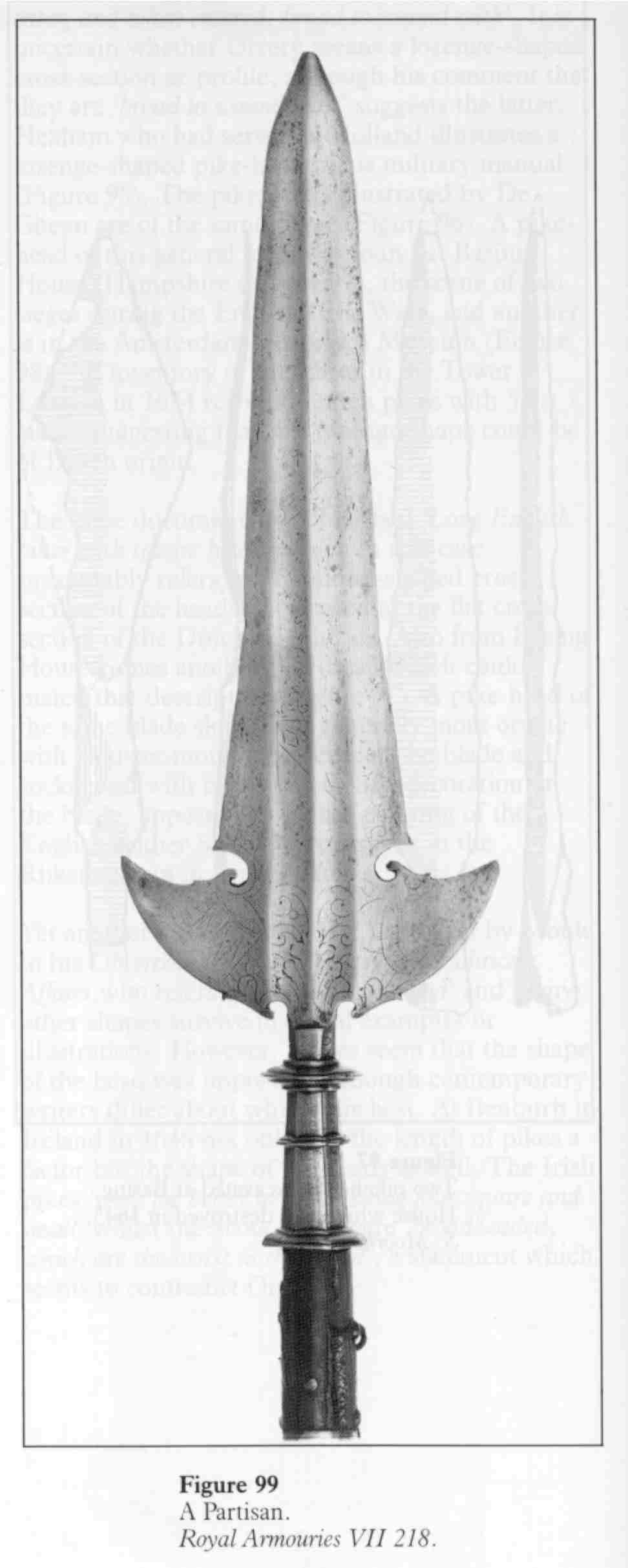

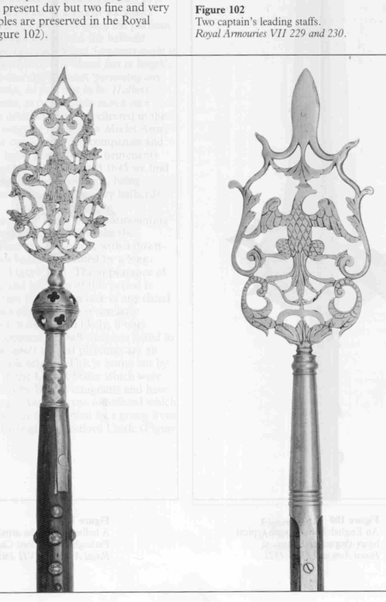

Under staff weapons Pikes, Halberds, Leading Staffs and Bills are described, here are pictures of a partisan and two leading staffs from this book:
According to Blackmore the Partisan was the staff weapon of the lieutenant and the Halberd that of the Sergeant. In the New Model Army Partisans where being issued at the rate of 10 per regiment which was the same number of lieutenants that these units where supposed to have. The leading staff, Francis Markham writing in 1622 also refers to these as feather staff, is a lightened version of the Partisan and he further goes on to state:
`The Leading Staff mentioned earlier is not strictly a weapon at all, although at the Battle of Cheriton in 1644 a Parliamentarian cavalry officer, Captain Flemming, was wounded by one. Interestingly the account was of Cheriton which records this incident refers specifically to “a captain’s leading staff” and indeed by this time it had become a recognised badge of rank for captains. Few leading staffs have survived to the present day but two fine and very different examples are preserved in the Royal Armouries (Figure 102).”
