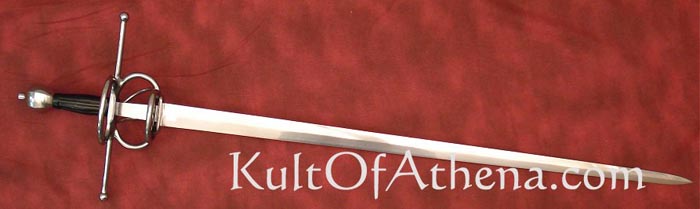

I'm ready to proceed with a new project based on the Windlass "Saxon hilt sword". By "based" I mean I'll keep the pommel and blade. These, plus a new, slightly recurved cross, will form a bastard sword inspired by the painting below (ca. 1490). In the painting, notice the blade of single-hand length paired with a long grip with "D" shaped chappe, recurved cross and faceted or fluted globular pommel. I won't go so far as to flute my pommel. Experiments with clay grip and cross suggest a balance point approximately 2.50 below the cross, which seems reasonable for a thrust-oriented blade. My photo mashup (see below) is only eyeballed, so final proportions will vary somewhat, but I think this is roughly what I'd end up with. Looking at the image of the saxon hilt sword you can see what I'm planning to do--everything between pommel and lower gaurd will become the hand-and-a-half grip.
Do any of you know of surviving weapons of these proportions? Any late 15th c. bastard swords with Type R pommels? Do you find the proportions of my design reasonable/attractive (sorry I don't have a full-length view)? What would you change?
