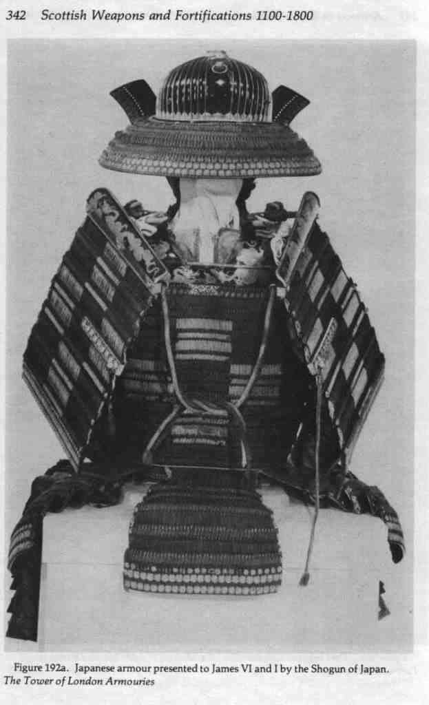

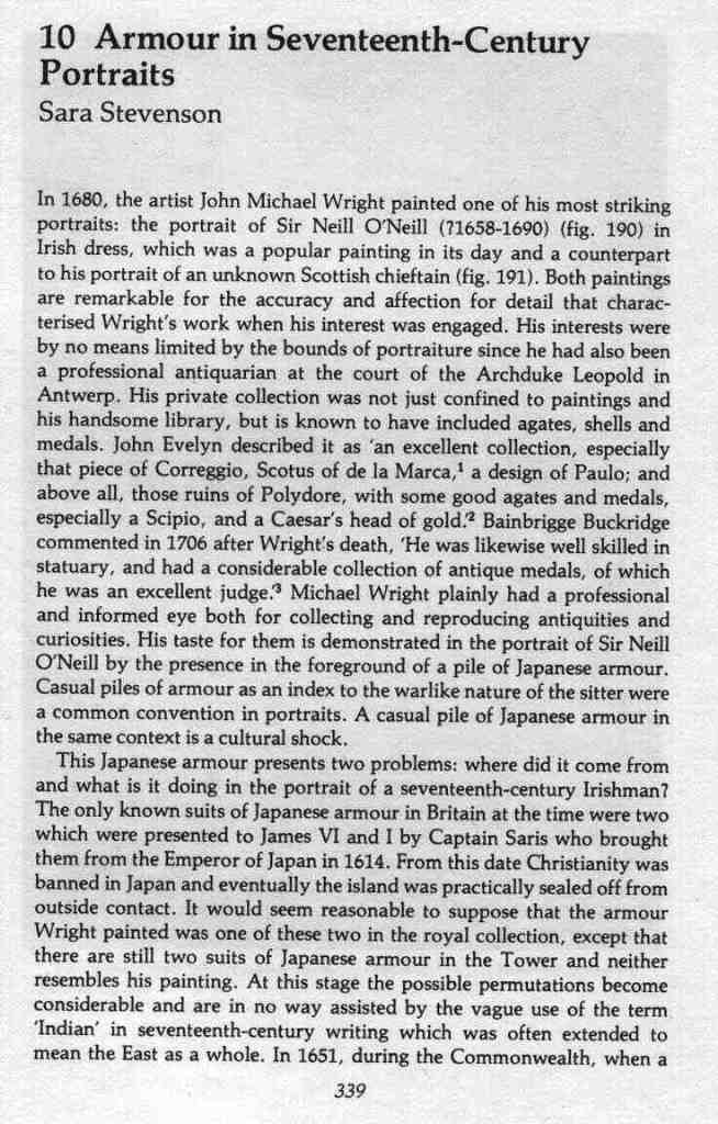

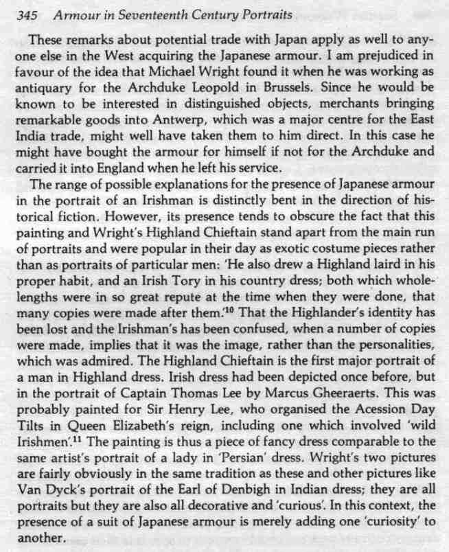

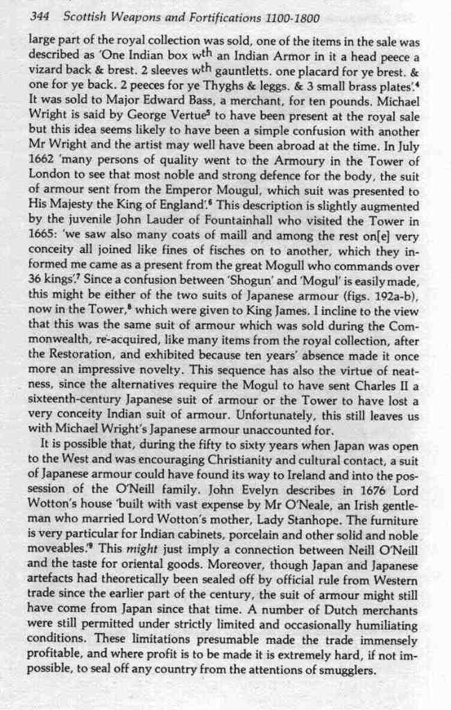

From Dr. David H. Caldwell's great book, "Scottish Weapons & Fortifications 1100-1800". , Mac
 Attachment: 84.42 KB
 Attachment: 89.98 KB
 Attachment: 69.19 KB
 Attachment: 37 KB
 Attachment: 33.21 KB
XX ANDRIA XX FARARA XX

PostPosted: Thu 10 Mar, 2005 6:24 am    Post subject:         Reply with quote
Here's a bit of conversation we had on this subject, back on the old Sword Forum ! Mac
September 07, 2001
Thomas McDonald wrote:
I've been reading about the 2 sets of Japanese armour that was presented to James VI and I , by Captain Saris , from the Shogun (Emporer) of Japan, in 1614.
In 1680 the artist John Michael Wright painted the portrait of Sir Neill O'Neill ( ? 1658-1690 ) in Irish dress...in the foreground a pile of Japanese armour?
As this artist was known for his detail , and since the armour painted was not one of the only two known to exist at the time, in Britian ( and still in the Tower Collection), where did it come from? And why was it in the portrait of a 17th cen. Irishman?
Ian Brackley wrote:
The 17th century saw a craze for "Chinoiserie" (probably spelled that wrong) Which was a originaly a French term meaning brick-a-brac or a cluttering of nick-knacks. The Dutch East India Company was enjoying unprecedented success in those days (it was at its zenith at time of the portrait) and as such was influencing European tastes with the shiploads of Eastern luxury items it brought in, most notably silk and Chinese porceline. The Dutch where also the only Europeans the Tokagawa Shogunate permitted to stay in Japan (albeit they where confined to a tiny island in Nagasaki harbour). The Portugese had soured relations with Japan with their omni-present Jesuits making converts from the lower and dissafected Japanese classes thus disturbing the social order (that how the Japanese saw it anyhow).
So the culprits for the armour's presence in the portrait are the Dutch merchants who probably aquired the pieces as curios that could be hawked quite easily on the European market. Whether or not the artist, the Irish Lord or any of the "middle-men" in the Eastern curios trade (possibly it changed through a few hands between Dublin and Amsterdam) knew or cared that it was Japanese (and ergo rarer then all the Chinese and South Seas goodies floating about) is another matter.
Its presence in the painting is no doubt the subject whishing to communicate not only his cultural pride (via traditional dress) but also his fashionable tastes for Eastern curios.
If someone more knowledgeable in Japanese panalopy could provide a time frame for the particular armour it might give more clues as to its origins and time of transport between East and West.
John M. Roberts wrote:
According to Ian Bottomley and A.P. Hopson in "Arms and Armor of the Samurai" (Crescent Books, 1988), concerning this portrait: "The artist has introduced an imported Japanese armour - the style is typical of those produced by the Iwai for presentation and should be compared with those shown on pages 136 and 139 (those James I armors: JMR) The servant carries the helmet bowl, the neck guard having been fitted around the waist in the manner of a European culet."
This suggests that the armor was shipped disassembled and the recipient did not know how to mount it correctly and assumed that the neck guard went on the body armor. As I understand it, armor sent to a reigning sovereign was accompanied by a skilled servant who would know how to mount it properly. Perhaps the pictured armor was of a type sent to lesser nobles. I saw that painting many years ago and it puzzled me for years. Likewise, a Dutch still life I saw in the Royal Portrait Gallery in London in the 70s that included, among the fruit and flowers, a wakizashi.
