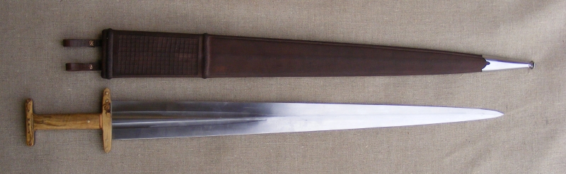

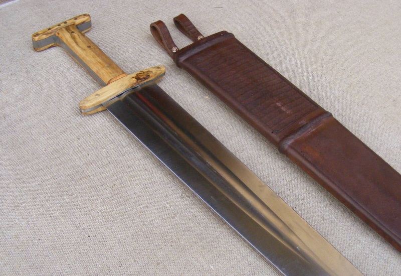

Well here are two very different pieces and in fact the title is a bit of a lie. The first piece is a baselard, but a darn big one, with a 26" blade. This piece is not based on a particular item, but has taken its inspiration from one in Oakshottes' Archeology of Weapons which is of a very similar size, but the hilt is a little different.
This piece is very much a large dagger rather than a sword and the hilt form precludes some sword moves, but I guess it got around some of the anti-sword legislation of the time. The blade was forged down from a larger billlet and the tang starts at about 8mm thick and goes to about 11mm at the top. The blades starts at 6mm and tapers down to 3.2mm (1/8") 50mm (2") from the tip.
The top loop is formed from 1.5mm steel and brazed to the tang. The scales are box wood with yew spacers and the scabbard is double layer vegtan leather.
Baselard stats
COP 17"
POB 5"
Thickness at hilt 6mm
Thickness 50mm from hilt 3.2mm
blade length 26"
Weight is 860g (about 1lb13oz)

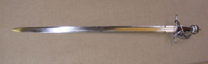

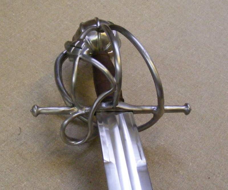

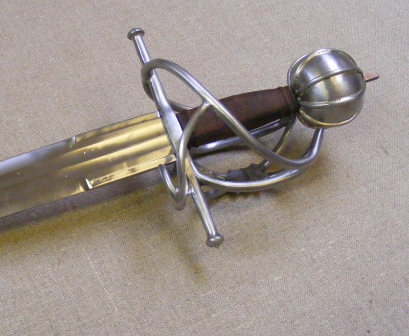

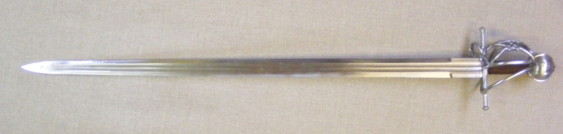

The second piece was more of a challenge on many levels, the first being that it was based very closely on the 'Southwark sword', a sword found in the Thames in the 19thC and dated to about 1540. I went to examine the original and there was no way I was going to be able to measure all those curves in any meaningful way so I took a load of pictures, but also made a macquette of the hilt with copper wire and a grip, that I used back at the workshop to help with the forms and clearances.
I noted a few interesting aspects to this sword that I had not expected. The overall manufacture was a little 'workaday' in that it was not a very highly finished piece; well made and structurally sound, but not a jaw dropper of the time. I tried to reflect this in my work in that the bars change in diameter and are still faceted from the anvil.
The pommel was actually quite a way from spherical and the side closest to the grip is 5mm flatter than the other side so that the whole is quite egg shaped.
The ribs on the pommel on my piece are brazed on, whereas on the original they are welded, but of the 6 or 7 swords of this form I looked at there was quite a range of construction methods using combinations of brazing and welding and many had brazed ribs.
The blade taper was interesting as it started at the guard at 6.2mm, dropped to 4.5mm over the first 90mm/3.5" and then was steady toward the tip, ending in it being very thin.
What was also very notable were 2 aspects to the blade that I really didn't expect. The blade has twin fullers that are actually formed into a flat, not a diamond. So the blade is actually a hexagon that has fullers on the faces rather than the diamond that I would have expected. The other aspect is that in all the photos I have seen the two outside' fullers' on the ricasso really do look like fullers. They are however steps not fullers at all. The ricasso is basically flat and the edge steps drop down about 0.5mm from the ricasso surface and are square edged and flat bottomed, they are not curved edged fullers. Having seen all this, when I ground in the fullers on my blade I ran them up to the tang rather than stop the at the start of the ricasso - yes I swore. So this aspect of the origial I have had to do differently. That said the originals I looked at have a variety of forms in this area, so what I have done is not wrong to the form; just damn annoying.
The hilt, though very small is true size to the original and just clears my knuckles by about 5mm all round, the pommel on my piece is hollow like the original, though about 4mm larger. The grip on the original shows no sign of any binding, so not wire, and I suspect not cord either, so either just a leather sewn grip, or no covering at all. I have gone for a cord and leather grip.
I have fitted the sword together but will not permanently assemble the sword until the scabbard is made, which will be early next year.
Early basket stats
Blade length 38"
COP 26"
POB 5"
Thickness at guard 6.3mm
Thickness 50mm from tip 2.0mm
weight 3.5lbs

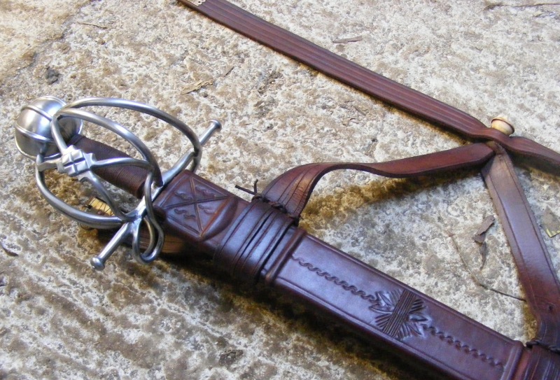

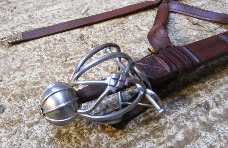

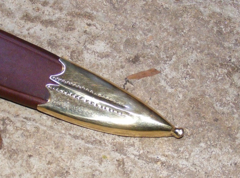

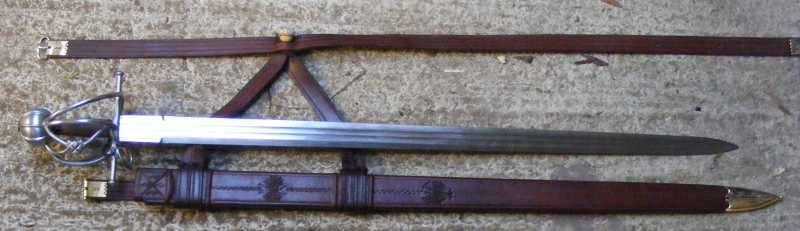

Well the basket hilt is finally finished with it scabbard and willI guess head off to its new home next week.
The scabbard is based on the most extant piece from the Mary Rose and Weapons of Warre provided the detail.
The original scabbard was not for the very similar basket hilt that was found on the Mary Rose but at least it meets the date exactly for this sword.
It is rather curious in that a few of the scabbards had a feature I have not seen before and that is a small piece of wood inserted under the leather near the neck to act as a riser and stop the straps of the harness slipping up. The original scabbard only had the crescent riser at the mouth and no other risers, but also had no visible method of stopping the hanger from moving so I added the other 3 risers toomake mine and Glens life easier. The other is that although the basic belt system is very similar to many 15thC longsword rigs in that the main belt passes through the buckle of itself and goes on to buckle to the top of the scabbard but instead of a hook or distributor to connect the sword hanger it has a bead in this case but in the originl a Turks head knot, so it is basically a button.
The decoration is also rather particular and is not something I would have ordinarily have done.

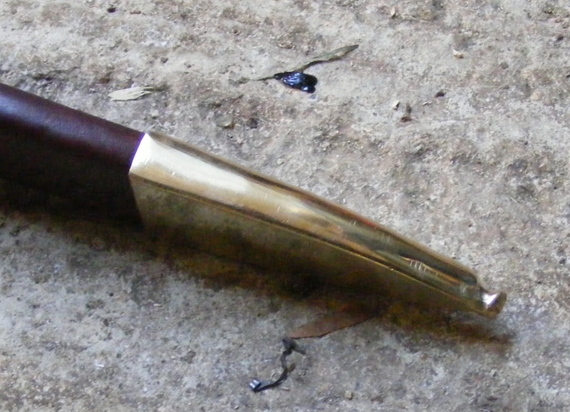

The chape is also interesting for me in that it is formed on the front and has a flat back. This was common in both medieval times and in the finds of the Mary Rose, but it is not a style I like. It is easier to make and so I guess commercial pressures were current then also, but I have always viewed it as an easy option. However for this project it seemed fitting to follow the manufacturng systems of its contemporaries. The chape on the scabbard I based this on was too corroded to make out details so I based this on another piece from the wreck.
Anyway I hope you like the result.
Tod
