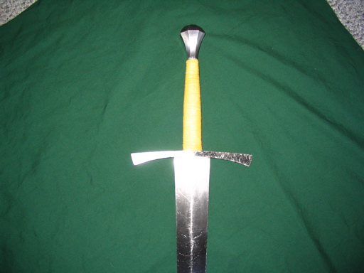

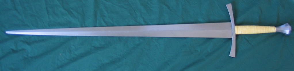

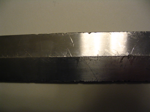

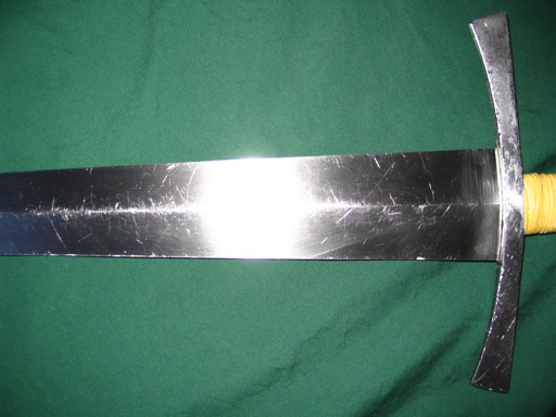

I was inspired by all the other DIY re-gripping projects, especially those done by Greyson Brown and Sean Flynt. So, I thought I would try my own. . .
My poor sword. Sad My Albion Squire Line bastard sword has seen much more use and abuse than it was ever designed for. As a result, her edge had several nicks and the grip had loosened and eventually developed a slight creaking noise. I contacted Albion about repairs, but the amount of damage that I had done to the sword was so great that repairs would have cost more than half the cost of the sword. Plus, I had to consider the hassles involved with shipping and waiting helplessly at home for her return.
So, with nothing to lose, I decided that she would benefit from a home spa treatment. The first step was to try to make the edge safe to use again. I took a hand file and slowly and steadily ran the file along the edge from the hilt to the tip over and over and over again. I had only enough patience to do this for about 15 minutes at a time before I needed to give myself a break and try again later. I eventually wore out three files! The end result is an edge that I can once again slide my bare hand down and not be in any danger of cuts or splinters.
The nicks were not completely removed, but that was not really my intention. I just needed her safe to use again. Once she returns to action after her sabbatical/retreat I’m sure that she will get banged up again. One side benefit of the filing is the new edge is wider than the old one. This should make the edge safer to use and, hopefully, slightly more nick resistant. I do intend to put her back to the use that she had before, so more nicks are expected.
With the edge back to a usable condition, the next step was to tackle the grip. After I removed the leather wrap, I discovered a few cracks in the wood. I applied glue to the cracks and clamped the cracks closed as the glue dried. The only glue that I used throughout this project was standard craft “tacky” glue. It dries quickly, it’s easy to use, and relatively strong. Plus, being a mom and Cub Scout leader, I always have it on hand. Happy
With the cracks repaired, I needed to recover the grip. I won’t go into detail there. I just followed Mr. Brown’s and Mr. Flynt’s excellent instructions. I used chamois for the wrap and since my favorite color is yellow, I left the chamois un-dyed.
The rewrap was far from perfect, but not bad for a first attempt. I’m also realistically looking at this as only practice. With all the hard use I put her through, I’m sure that the repair will not last long. The next step will be to put on a new wood handle and rewrap again with a little more experience. (But I will stick with the chamois yellow. I really like that color!)
I’m looking forward to putting her back in action. Her edge is now wider and no longer such a danger to my sparring partner or my instructor.
Yes, I do keep referring to my sword as “she”. I may have anthropomorphized her just a bit. Wink Even after all I have put her through, she’s still my favorite sword in my collection, and my alter ego. Just like my sword, I’m also a middle-aged lady with visible wear and tear. Eek!
I’m attaching some before and after pictures. Please be kind and ignore the lack of professional photography. Happy (Edited to reverse the order of the photos.)
 Attachment: 63.91 KB
A shot of some of the damage done.
 Attachment: 66.82 KB
Another shot of the nicks. The scratches on the blade are very superficial.
 Attachment: 93.2 KB
the new edge
 Attachment: 72.25 KB
The grip is not really that bright of a yellow, just a result of poor photography.
 Attachment: 78.89 KB
The spa treatment completed. [ Download ]
