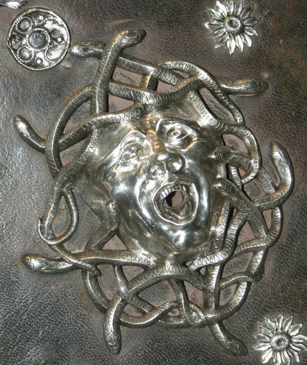

Some information on two original targes
I was recently in Scotland, having joined Vince & Grace Evans on one of their amazing research trips, and got to handle, photograph, and take stats on a couple of
targaid in Glasgow.
Although I am unable to share my photos without permission from the museum(s) I can give a few stats on them!
Slàinte, Mac
.40-45 dm
-An elaborately decorated targaid in the Kelvingrove collection (which we viewed at the Glasgow Museums Resource Center).
Overall diameter - 19-1/2"
Weight- 6 lbs. 3 oz.
Central Boss - 3" diameter. (pierced with circles, and cutout with arrow shaped openings, red fabric underneath.)
Edge thickness - ½"
Retains it’s leather forearm strap, fabric & leather wrapped handgrip(cord style), and spike sheath (spike missing).
Animal skin backing, well worn.
Frontside decorated with tooled leather, circular & triangular pierced brass plates (red fabric cutout & inserted underneath), and various size tacks/studs in circular array.(some missing). Some of the brass plates are also missing portions.
*Edit - I just recalled that Ron Luciano had taken a photo of this piece when it was on display at the Kelvingrove Museum, back in the summer of 2003. So although I can't post my detailed photos from the Reserve, I can show this publicly taken shot.
It certainly is a beautiful piece, 'eh ! (* Aaron, this is the targe I was describing to you in my Scotland trip thread!)
Boss detail .... (cropped from a larger image of the photo above)
INV. 35 2/111
- Targaid in the Burrell Collection, Glasgow.
Overall diameter- 18"
Weight- 3 lbs. 13oz.
Central Boss- 3" diameter (engraved, missing center plug/spike?, edges scalloped and tacked on)
6 smaller 1-3/4" dia. bosses, spaced in circular design, each having a central pierced hole.
Edge thickness- 3/8", ½" with frontside leather (backing missing).
Frontside- browned tooled leather with various size tacks/studs in circular array.
Six triangular brass plates(one missing, and 2 missing portions).
Some of the tacks/heads are also missing, and a few small areas of the leather are split/damaged, as well.
Backside- no materials, wood ply exposed (4 sections, multiple pegging).
Central staple for boss turned over and embedded.
It has two raised rectangular iron studs for securing forearm stap, and a hinged iron handgrip that swivels back & forth.
(hand area is beveled over).
There is edge damage near the handgrip, and some cracking on the backing ply.
Worm hole damage is also present.
