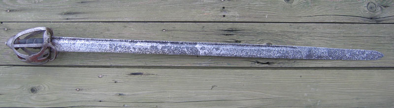

Hi All,

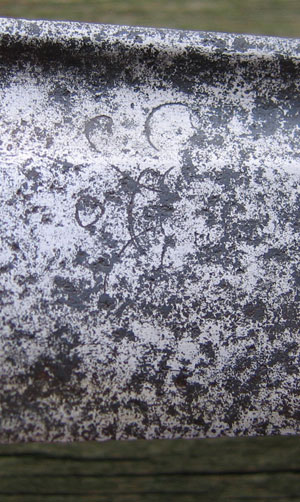

Since this is where the "basket Heads" seem to be congregating I thought I would post this one. It appears to be a Twysden-style backsword. The total length is 42" with a blade length of 37". There is some faint engravings but most of it is lost to corrosion. There is mild hilt damage as well.
Any and all comments good and bad are welcome.
Thanks
Jeff

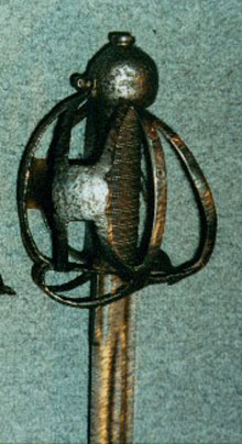

For reference, here is the Twysden sword:
PS--The hilt decoration has always reminded my of the A&A Elizabethan Rapier. Wouldn't it just be a natural progression to reproduce this hilt? Please?

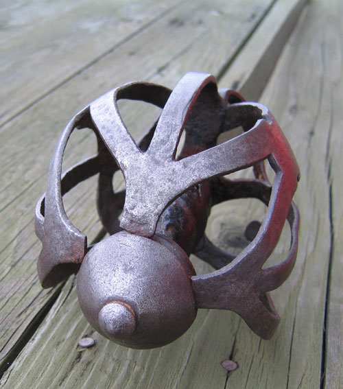

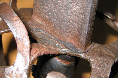

Hi Jonathan,
My guess to age is somewhere in the last half of the 17th century but I cannot be sure. The backsword blade of this style is consistent with that age, maybe a little later. It is quite massive at 37" (total sword length 42"). The hilt style is also consistent with the later 17th date, but the pommel is strange. The groove for the guard goes half ways around much like the ribbon hilt's pommels. Maybe it is a later add on or possibly a transition I don't know. I have shown a weld break at the back of the basket, there is a smaller one on one of the side guards, I would like to know if these are typical locations for the welds?.
It is a very impressive piece to hold.

That looks like a decent sword. The pommel isn't what one usually finds on this type of hilt, but it's not out of place, either.
The welds were pretty much up to the hiltmaker, so you can find variation in construction. What I find interesting about the weld in your photo is that it looks like it has a rivet for reinforcement or repair.

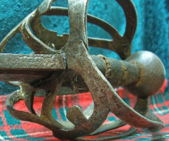

PostPosted: Mon 29 Jan, 2007 7:42 am    Post subject:         Reply with quote
Don't discount that the blade could have been a replacement. Look closely at the intersection of the basket and blade and you can see the characteristic corrosion of a lead fill or shim to close the gap and tighten the blade in place. The stoutness of construction also puts me in mind of a military "munitions" weapon.

Hi Eljay,
Thanks for the comments. I hadn't noticed a rivet but with careful inspection I think you are correct, great eye! This one definately handles different than your old Henckel, because of its size it has to be a cavalry chopper. The grip isn't near as nice either Wink . This blade has a couple of areas of deep pitting that might have a mark at the bottom do you know of any tricks to removing the old rust?
Hi GG,
The shim you can see in the one photo is the original leather "washer' I will show photo's below. The basket is as you say a more munition grade, but the blade is unbelievably light for its size. I think this piece was made for service .
