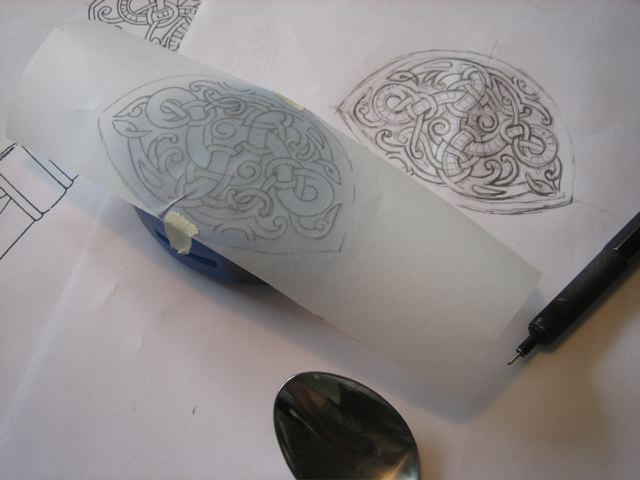

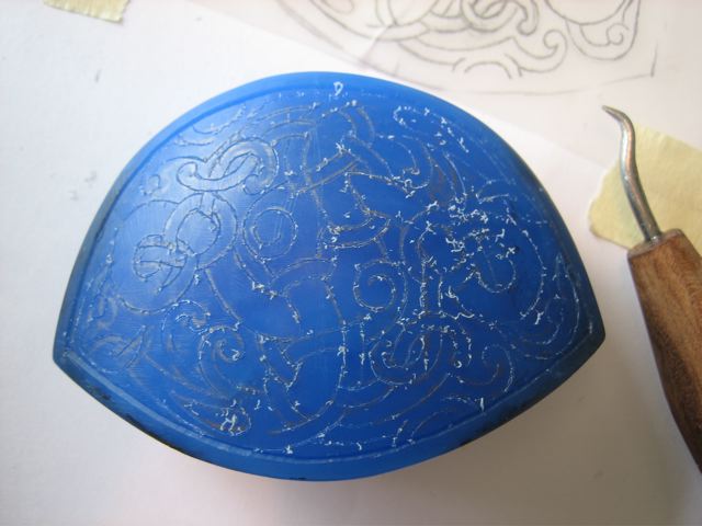

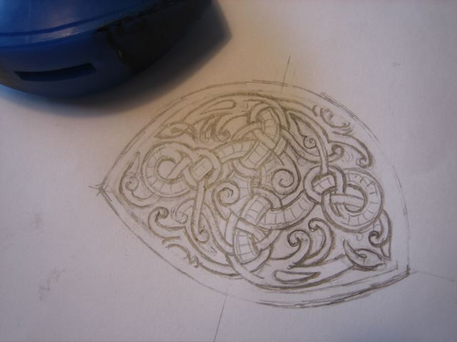

The pattern is first drawn on paper, then traced on transparent paper that is turned over and put on top of the wax. I rub the transparent paper with a small spoon: some of the lead will leave a mark on the wax. That is the guide for the initial tracing. A needle like tool is used to re define the lines and make an adjustments of the shape so it fits well to the wax original.
The pattern is now going to be carved in relief to create volume and an impression of depth.

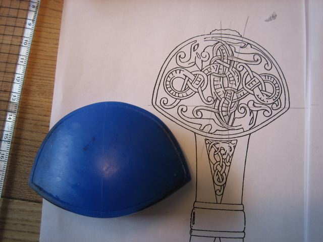

Some more update pics showing stages from sketching the pattern, transfering, tracing and cutting and finally working to cut away the background (not yet finished).
Photos does not yet show the sculpting of the dragons themselves. That will not be done untill the background is cut away to uniform depth.
 Attachment: 50.41 KB
Wax pommel compare to a drawing of the original, that serves as inspiration for the sword hilt. Note slight differences in shape.

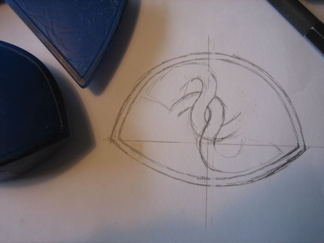

Sketching of pattern has begun. It will essentially be the same dragons as on the original, but adjusted to the shape of the wax pommel. I also want the dragons to cover more of the surface, with less background showing between the knot work.
 Attachment: 36.58 KB
Sketch ompleted. Some adjustment will stll be done after the pattern has been transferred to the wax. This is still just a guide.
 Attachment: 35.39 KB

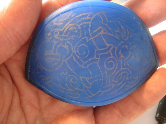

The pattern has been drawn on transparent paper with a pencil. The transparent is placed with pencil lines towards the wax and rubbed with a spoon. Some pencil lead will make a mark on the surface of the pommel.
 Attachment: 43.51 KB
...Traces of pencil lines will act as a guide for the next step...
 Attachment: 48.36 KB
...That is to re-define the design with a fine needle like tracing tool. This is the foundation for the actual carving.
 Attachment: 58.95 KB

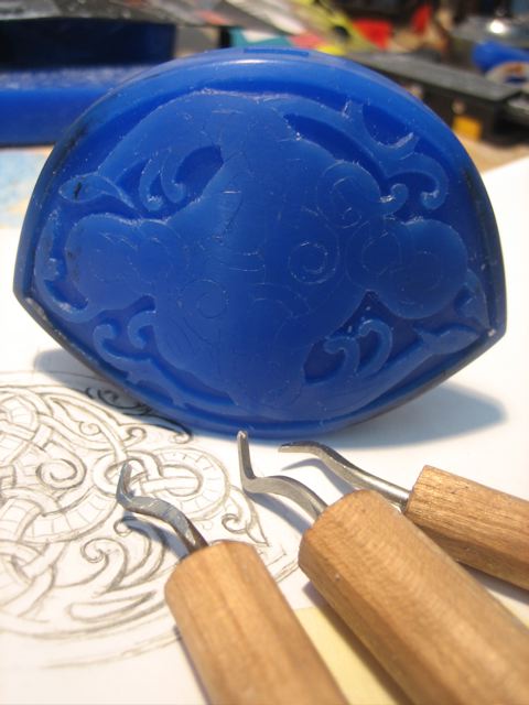

Carving starts with the sunken background. It needs to be cut away to a uniform depth defining the outlines of the two dragon beasts
 Attachment: 49.58 KB
Here the background is cut away completely around the perifery of the two beasts. No definition of the actual knot work is yet done.
Next step is to cut away the small areas between the intertwining bodies and make sure the background is finished evenly

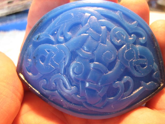

Before I go on carving the background on all four faces of the hilt, I wanted to see what the three dimensional modelling of the dragon beasts might look like. Any adjustments in the design needs to be done at this stage.
A test of the mid portion looks like this. It is not what the final carving will look like, but it hints at what the final effect will be.
I also needed to see what effect polishing with soulution has on the edges of the shapes. It dissolves the surface of the wax and thereby rounds of sharp edges. This nees to be taken into account, especially as the details are smallish. I don´t want the dragon beasts to look worn and indistict, but they should have a slight rounding. The solution can be used in giving the right final rounding of the edges, and I needed to test how much it will affect the modelling.
A quick snapshot gives an idea of the effect. Bear in mind that wax reflects light a bit different than bronze. It is semi transculent in thin sections and so plays tricks on the eyes when small details are carved.
You might make out some scratches in the surface here and there. This illustrates the need to have well honed tools. Uneveness in the edge leads to fine lines scraped into the surface. It is laborious to remove such scratches without altering the shape.
