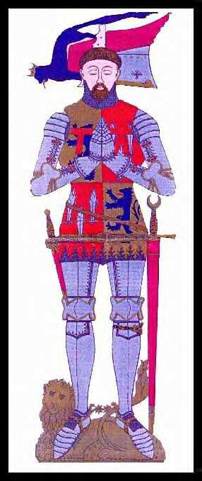

Glen A Cleeton
Location: Nipmuc USA
Posts: 1,979
PostPosted: Sat 25 Dec, 2010 3:09 pm    Post subject:         Reply with quote
Christopher Domanski wrote:
Nice find Glen! Would you consider posting some more info about that gentleman on the effigy? A name would suffice, but a date of death would be just terrific.
What was the best source for Perci/Percy information is now behind an archive .com link after geocities shut down pages. This should link to the second house of Percies at Alnwick (Potter's castle in modern fiction).
http://web.archive.org/web/20091027040015/htt...indit.html
The figure is a modern art effigy of Harry Percy (aka Hotspur) who was killed at Shrewsbury after leading a rebellion prompted by Henry IV denying wages and ransom funds due as an overall wedge between England and Scotland. It is a good long tri family story from the first (Princes) crusade up through the gunpowder plot and beyond. The various Percies often waving the losing flag of politics.
The pronounced crescent the art sword shows is undoubtedly adopted from the family badge but my feeling that Harry's favorite sword (moaned over when leaving it behind just before Shrewsbury) was more likely a less pronounced crescent but acquired by him because of an O type that fit/found his excuse for it. It may well have been much more similar to the Namburg sword or the XVIa now mentioned by J.D.
I had posted a more graphic version of the above on that page linked and I had also posted it to a thread on livery badges an several more times in heraldry threads.
http://web.archive.org/web/20091027115941/www...tspur.html
http://web.archive.org/web/20091027145009/www...spur1.html
GC

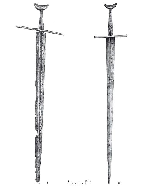

OK, so here are what two of the three known 'type O' pommel swords actually look like.
#1 on the left is a type XII found somewhere in Western Germany. This is the inspiration for the sword that Craig Johnson at A&A is currently working on.
#2 on the right is an XVIa found near Pardubice, Czech Republic.
 Attachment: 19.84 KB
Type O Pommel Swords.
Modified and reprinted (by permission of the author) from Aleksić, M (2006) Swords With Pommel Type N, Slovenská archeológia LIV-2, 363-388

PostPosted: Tue 11 Jan, 2011 7:25 pm    Post subject:         Reply with quote
Thanks for sharing J.D.,
That type XII is an excellent inspirational choice. The type XVI.a next to it isn't too shabby either, though of a later date i'd gather. I guess this type O may have been used for quite a while. Interesting to see usage on very different blades despite such a paucity of archeological finds.

Great stuff JD. Thanks for putting these drawings up! When should we expect to see some pictures of this beast?

PostPosted: Wed 12 Jan, 2011 3:39 pm    Post subject:         Reply with quote
For what we are accustomed to seeing the guard looks a little 'longer, if seen alone.
Yet, the collection is magnificent, if it were otherwise it would not be so beautiful.
A wonderful XII. Definitely prefer this to XVIa
