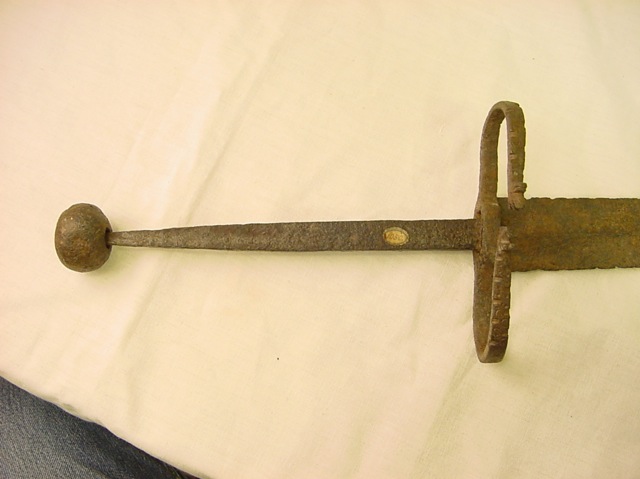

PostPosted: Wed 20 Jan, 2010 1:29 pm    Post subject:         Reply with quote
Here are som other examples from SHM in Stockholm. I have some more pictures somwhere but for some reason there was an error while trying to attatch the files. Can upload them tomorrow if there's interest.
Great projekt Sean! I have something similar coming from a Del tin blade...

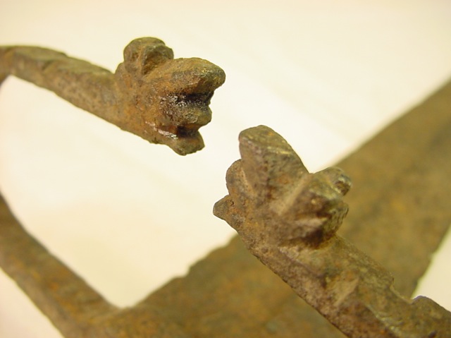

Here´s one example of that C-shaped guard type. A bit ornate, that is not usually the case. Most are ribbon shaped.
The pommel is fairly typical in shape. Not quite a sphere.
This one has a blade of type XVIIIa.

Eric Hejdström
Location: Visby, Sweden
Joined: 13 Mar 2007
Posts: 184
PostPosted: Wed 20 Jan, 2010 1:37 pm    Post subject:         Reply with quote
Peter, isn't there a very similar sword at Kulturen in Lund? I think I hace a picture of it somwhere...
I really like these swords. Insanely long grips but very nice handling characteristics. And quite impressive too.
Peter Johnsson
Location: Storvreta, Sweden
Joined: 27 Aug 2003
Posts: 1,757
PostPosted: Wed 20 Jan, 2010 1:41 pm    Post subject:         Reply with quote
Yes, that is correct :-)
There is one very like this one in Lund. I only have the written article about that sword, not any first hand documentation. I do think that sword has parts of the grip preserved with some kind of wire binding. The C-shaped guard on the Lund sword also has small dragon heads (and possibly also the same kind of decorative notches). And a spherical pommel.
The blade has (silver?) inlayed markings from Passau and is of type XVIIIa.
Perhaps these two swords are sisters?
It is a popular type, that is for sure. Quite a few survives, showing many variations to the theme in both details, blade type, proportions and size.

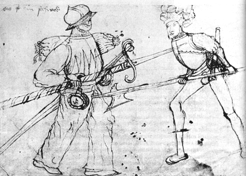

Here is a drawing by the german soldier Paul Dolnstein, who fought Swedish levy soldiers in the early years of the 16th C.
Note the big and very long gripped sword strapped to the waist of the swedish guy on the left (who is just about to enter a world of sorrow and pain...)
The smart looking and fashionable guy with the halberd is of course a german mercenary.
