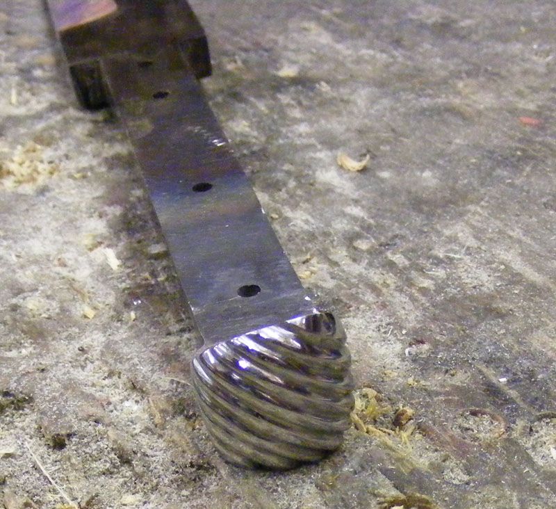

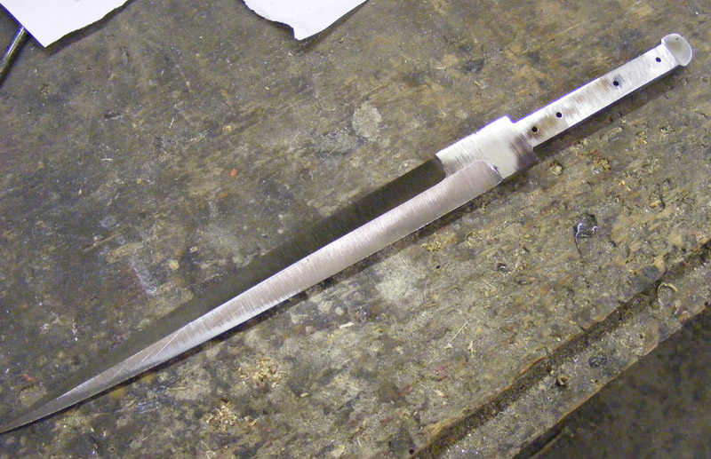

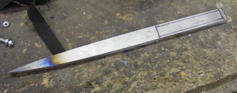

Yes Jean; here it comes!
This will be another 'making of' thread at the special request of myArmoury regular Jean Thibodeau.
Jean gave me about as open a brief as you could wish for, which was for an ear dagger. Jean asked for my opinion as to suitable specifications. We both seemed to be thinking along similar lines and so after a single mail pretty much nailed down the detail that was important to him and the rest will evolve during the project.
The dagger will be in many respects an unremarkable piece in that it is not a copy of a specific piece but will composite elements that were common to the style. It will have a hollow ground blade with an assymetrical ricasso, a very heavy blade section (about 8-9mm in this piece), a straight tang that has handle scales that protrude each side, and an enlarged 'pommel' that sits between the ears.
I have not got round to thinking too heavily about the scales or the scabbard yet, but the scabbard will again be fairly normal. Ear dagger scabbards were quite unusual in that they were often almost circular in section and so do not match the blade form like most scabbards do.
The progress pictures I have here show the basic blocking out of the blade profile, the handle holes having been drilled and the end of the tang having been upset to thicken it to allow the pommel section to be formed (some additional steel was added to bulk it out). The bevels were roughed out to remove some material and show approximately where they will go and I laid in the grooves on the top of the pommel.
The next step will be to heat treat the blade and finish the grind.
I hope you find it interesting.
Tod
 Attachment: 188.78 KB
blank roughed out
 Attachment: 192.38 KB

 Attachment: 173.34 KB
pommel grooves laid on and polished

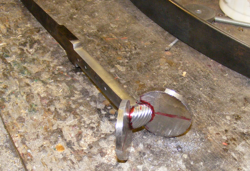

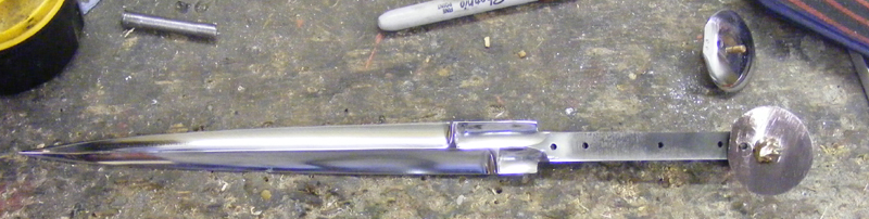

Thanks all. And thanks Dan P. What I really meant by 'unremarkable' was that it would not be an unusual piece; thanks for the compliment though.

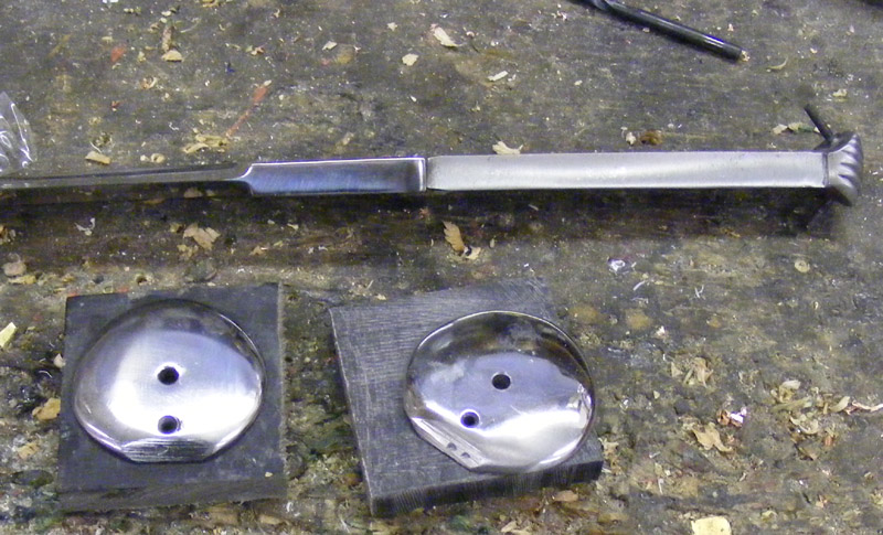

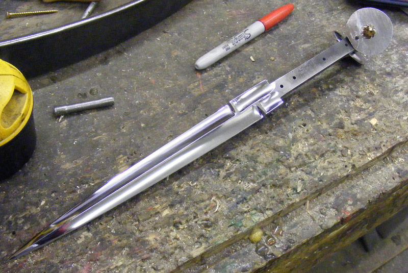

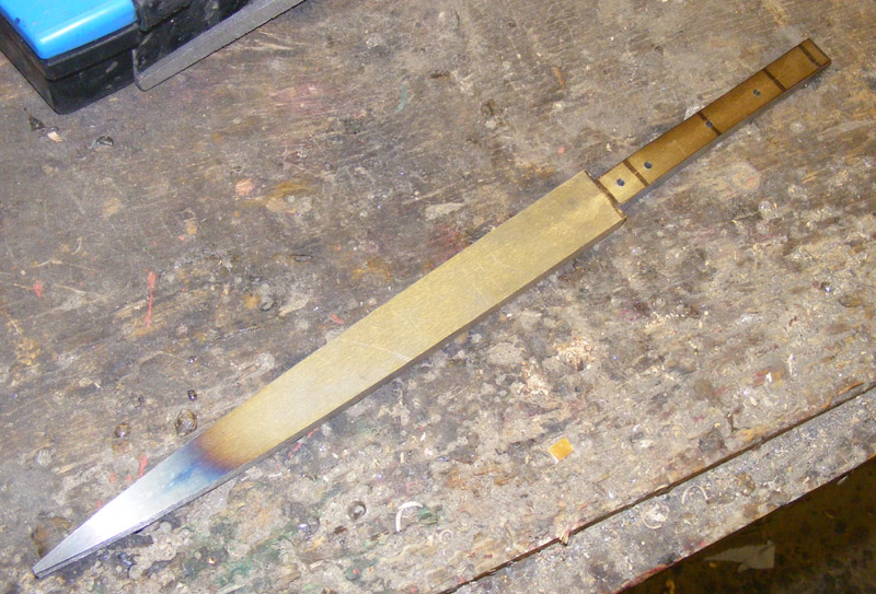

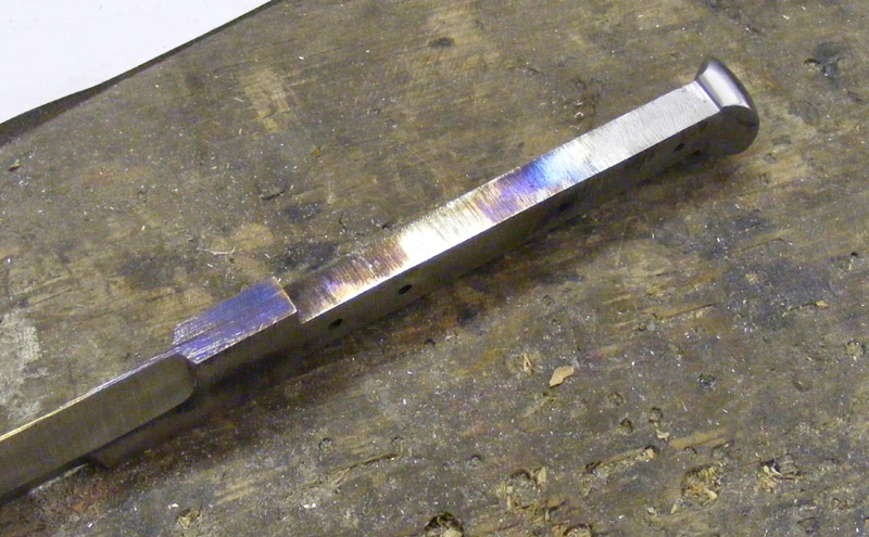

I made some more progress today.
The first step today was to cut the discs for the ears and set them into position. They are secured onto the tang using two pins that are soldered into the tang and will at a later stage get rivetted down onto the ears, but for the moment everything is just getting sized up.
The ears are then marked to show which areas must stay flat, to sit well against the tang and which areas will get rounded off. The ears are then rounded off and the decorative studs that will hold the ear plates on are placed into position.
The next stage was to heat treat the blade, followed by the hollow grind to the blade faces.
Finally I decided to add some secondary fullers to the ricasso. This is in fact where I have strayed away from 'unremarkable' . I have seen this on an ear dagger but it is by no means common and is something I have wanted to try for the last couple of ear daggers I have made, but just haven't got round to.
Everything got polished up and sharpened and that is where it got left for today
Tod
 Attachment: 156.45 KB
ear discs marked up and pins soldered in place
 Attachment: 192.4 KB
ear discs are rounded off

 Attachment: 182.33 KB
hollow grind to blade faces and grinds to ricasso
 Attachment: 175.41 KB
a full length picture so far

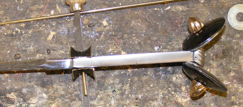

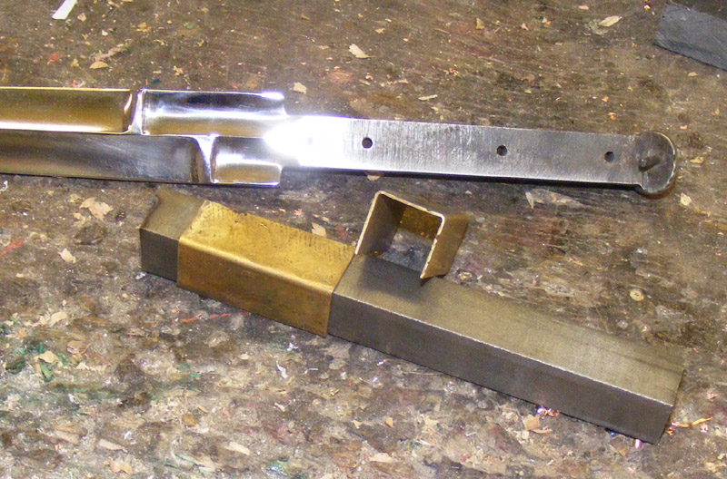

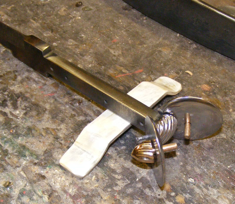

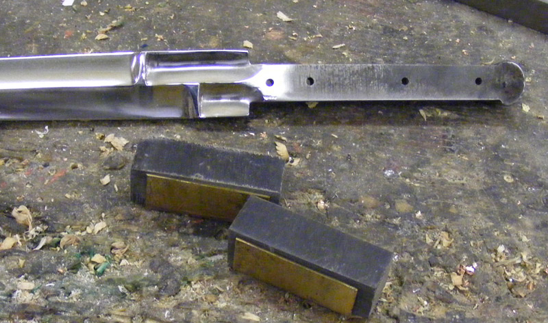

Thanks Luke. The handles on these daggers are quite small and so you have you have to hook your thumb over the top between the ears and so this of course provides a very strong and supported grip.

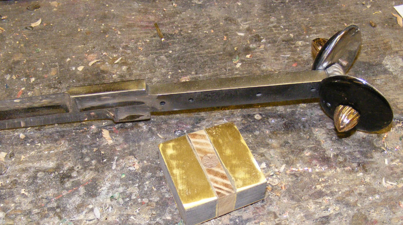

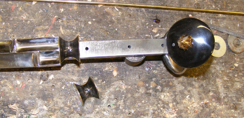

I got diverted for a couple of days by a powder horn, but I made some more progress today. I have posted this up on www.facebook.com/todsstuff for the curious.
Most ear daggers have a wierd ring part of the handle just behind the blade and this one is no exception, so I made two channels of brass and bonded in horn. I then bonded these to a piece of wood the same thickness as the tang and turned a cylindrical form, split the wood away and this leaves the two handle parts.
I also cut out and shaped two horn discs for the ears. I have made these assymetrical so that the top of the ear tapers more gently than the bottomfrom the rivet to the edge and the spiral rivets are also not quite central and the ears not quite circular. These aspects are all quite subtle in the pictures, but again are all quite usual.
With luck I will work some more on this tomorrow.
I hope you like the progress.
Regards
Tod
 Attachment: 162.39 KB
ear horn plates blocked out
 Attachment: 181.37 KB

 Attachment: 192.75 KB
front disc channels
 Attachment: 154.95 KB
horn bonded in
 Attachment: 173.77 KB
ears in position and handle disc block ready for turning
 Attachment: 160.11 KB
discs and ears in position
 Attachment: 193.2 KB
discs and ears in position 2
