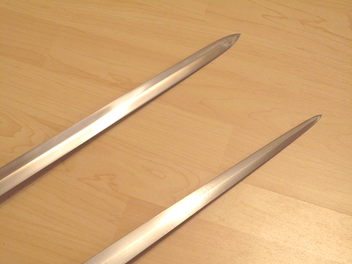

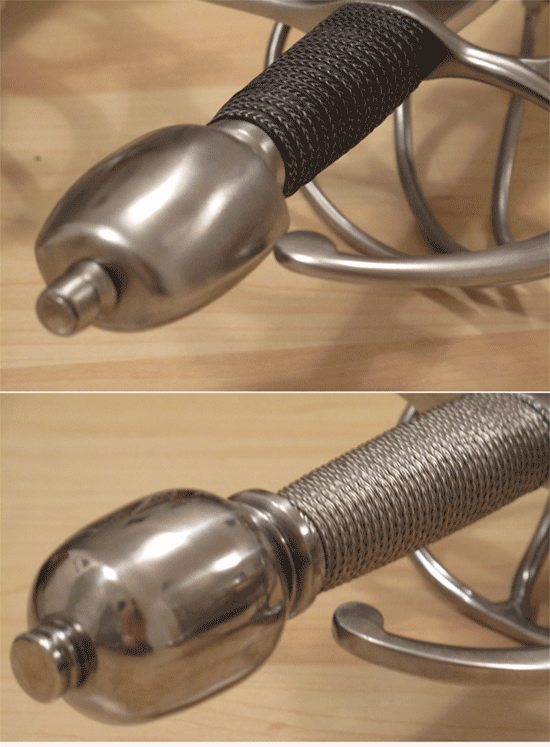

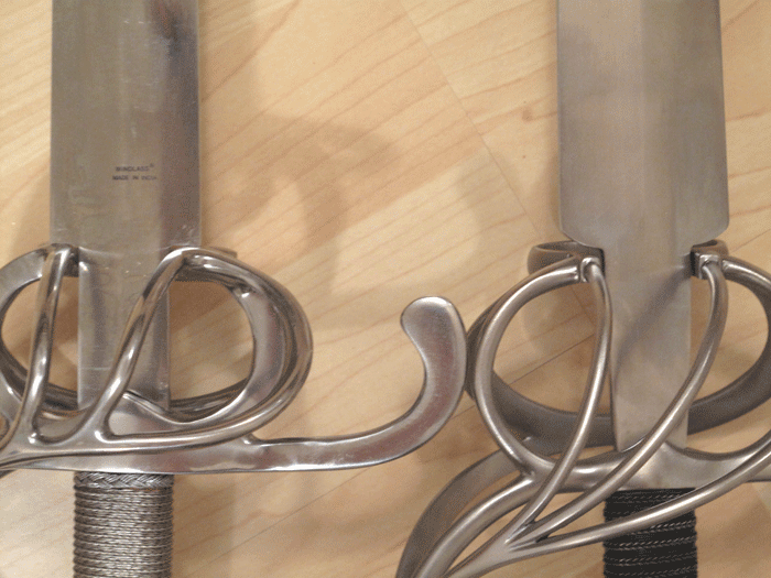

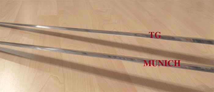

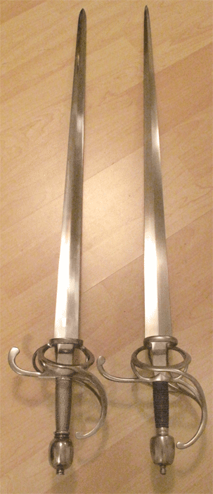

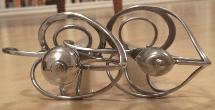

I probably won't compare these swords in detail in my formal reviews, so I'm just going to let the photos speak for themselves here. All of the Munich's problems should be clear from these. The quality difference is evident but, again, so is the price difference. By the way, as-is, the point of balance points of both swords is within approximately .5" of each other, with the Munich balance closer to the hilt. That's good, because that hilt is going to lose more weight than the blade during my work and I think this piece could stand a bit more blade presence.

Hum...Seeing these shots I'm starting to find it very hard to believe that this windlass was not a attempt to copy the A&A (though it can be argued that there is a great deal of these swords that are almost identical in various museums)...
I need to learn how to weld these hilts together...
Thanks for the very informative pics Sean...I've wanted to compare these two pieces fo a while now and this is just perfect.

The Munich pommel is one of the things I find most telling about the Windlass R&D. If one sees only a typical photo of one of these swords, there's little to suggest that the pommel is flattened. To catch that detail you either have to dig hard for some oblique views of antiques or the A&A Town Guard. The fact that Windlass has now made at least two swords also in the A&A catalog (Munich and the "Erbach Sword") adds fuel for speculation, but it must remain speculation.
I should add here that my upgrade of the Munich sword will be based on photos of originals rather than the TG. As good as the TG is, I don't want to get into the habit of parroting other reproductions. That's one reason I alter almost everything that comes through my hands. I want something unique!

Update on the Windlass sword. The pommel is the screw-on type and is pierced only about .75 of its depth. Drilling all the way through and peening, as one normally would do for an upgrade, probably isn't possible unless you want to take a bit of blade to reclaim some space for the grip. The good news is that the pommel isn't screwed down all the way as shipped so all you have to do is shorten the grip and screw down the pommel to get the more correct proportions. Big Grin
The pommel is NOT going to work loose on these things, by the way. I had to clamp it in a vise and use the hilt as a wrench to get it off and still struggled with it. "Tight" ain't the word.
I confirmed that, with simple modifications, the Hanwei-Tinker bastard sword blade should work quite well for a more advanced upgrade. In addition to being thicker than the Windlass blade, and closer to correct in profile, it has enough tang to allow through-drilling and peening of the pommel.
I think the pommel problem detracts a bit from the value of this piece because it virtually prohibits proper (re)construction with the original blade, but it's a virtually invisible problem. The only clue would be the absence of the peened tang on the button (which could easily be simulated, of course). The main technical problem it presents is in aligning the vertical edges of the reshaped pommel when screwing it into place. But, given the extreme difficulty of tightening or loosening this part, I think that once it's in position it isn't going to shift.
