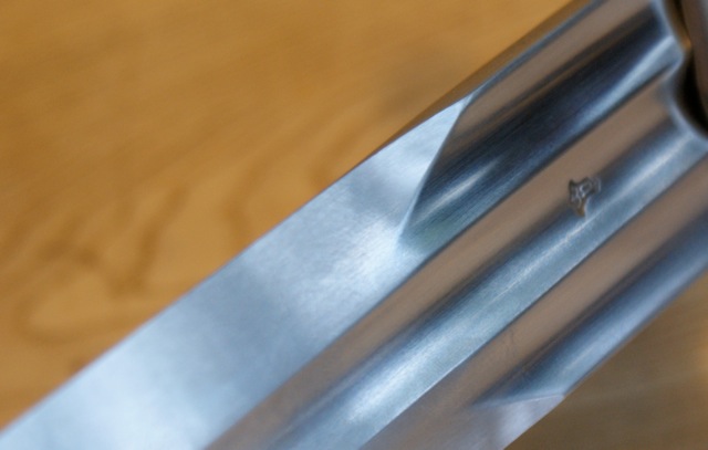

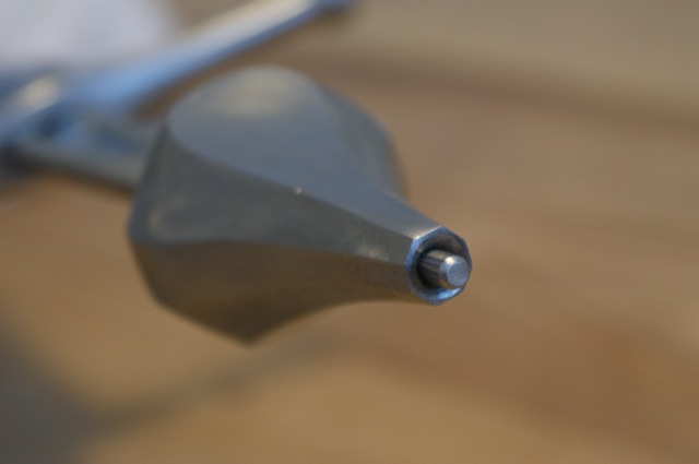

Some little progress has been made.
Since last post the guard has now arrived at its final form with work on surface finish yet to be done.
Rivet shank and pommel has been prepared for peening.
Some more light grinding has been done on the blade to refine cross section, point and ricasso.
The sword is now some 15 grams lighter and starts to come alive in the hand.
-Thanks for looking!

Some progress has been made since last. The sword is now riveted together and I shall next start work on fitting the grip.

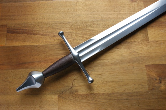

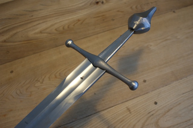

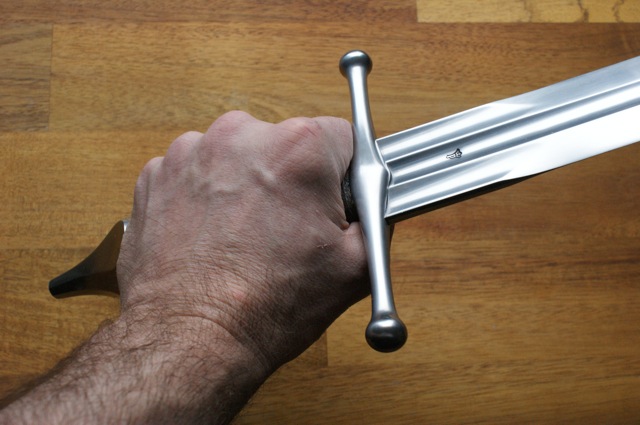

As promised, here are some snapshots of the semi finished grip. The core is carved from alder wood in two halves and fitted to the tang. It has then been wrapped with a relatively thin cord with risers at each end. The cord wrapping has been given a first sizing of hide glue and dried over night.
Next step is now covering the grip with leather. I will probably use a thin and strong goat leather. It is dense, wear resistant and does not add much bulk to the grip.
On the original there were traces of the original grip surviving as traces of wood adhering to the tang and leaving marks on the guard and pommel. From this is it possible to get a very good idea of its original size and form.

The grip is short with the pommel forming an ergonomic function. Its shape is effective in providing support for the heel of the hand.

I've also noticed that with most of my better handling swords the pommel gives support to the heel of the hand ( One handed swords ) and this really makes it easier to make and control sudden stops with a sword which may mean avoiding going to far with a swing and being able to recover faster from a miss and keep one's point menacing.
As much as a well designed pommel can help you a poorly design one will get in the way and often make the gripping of the sword uncomfortable at the least.
Well, with my Albion Doge I find the same type of pommel very useful and comfortable as you describe.
