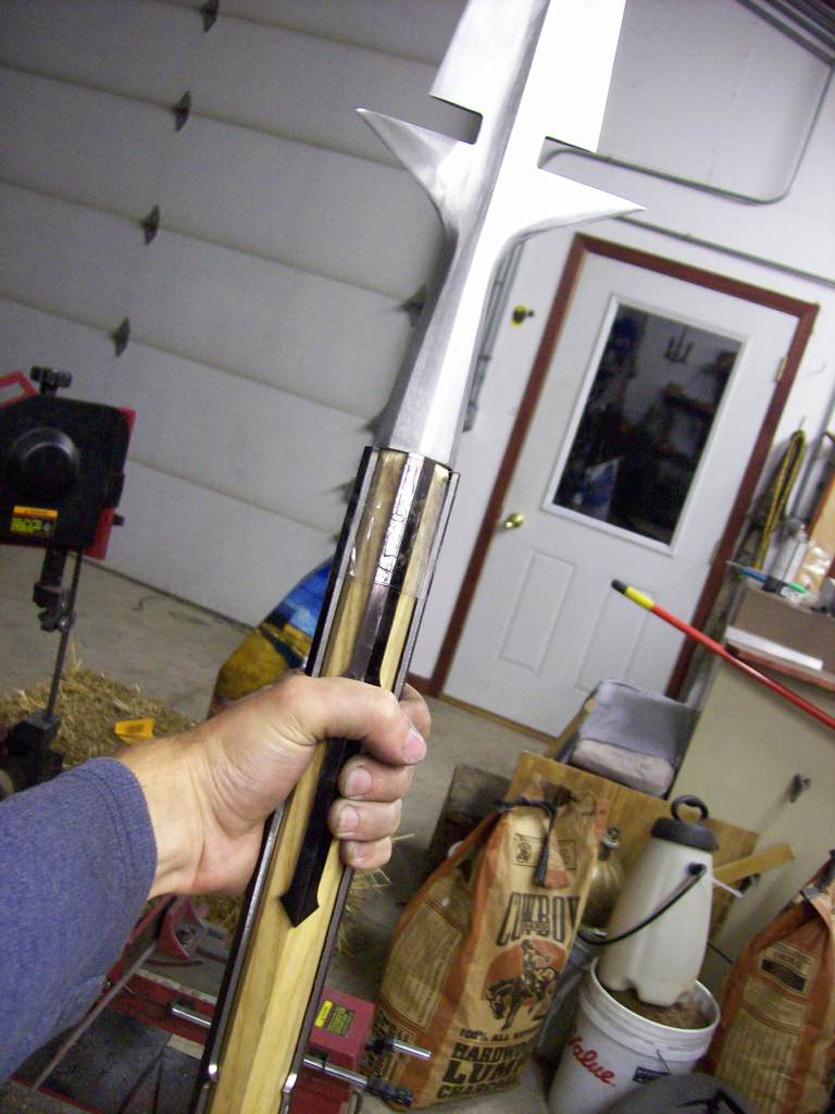

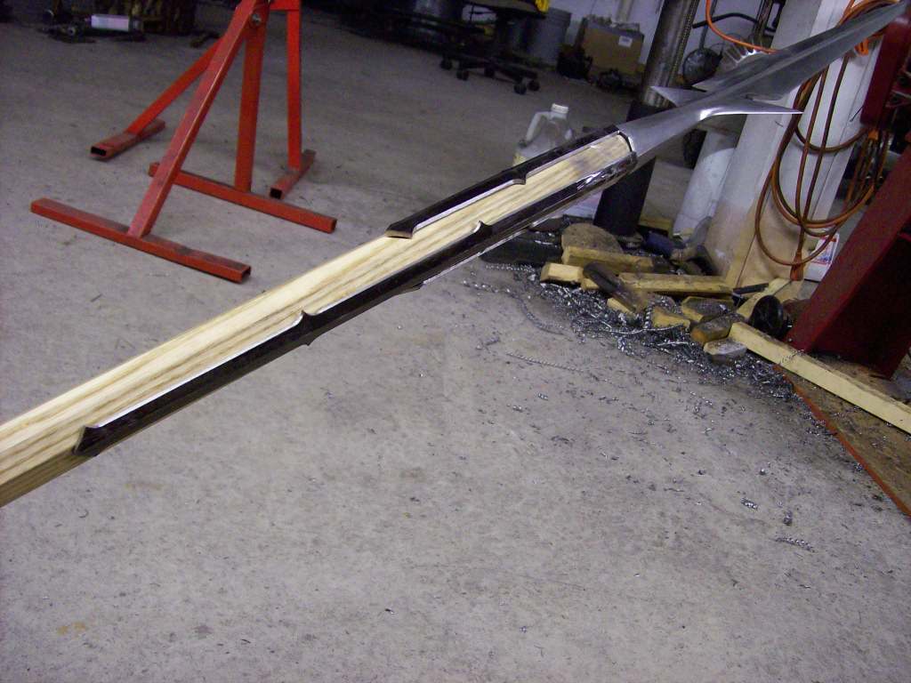

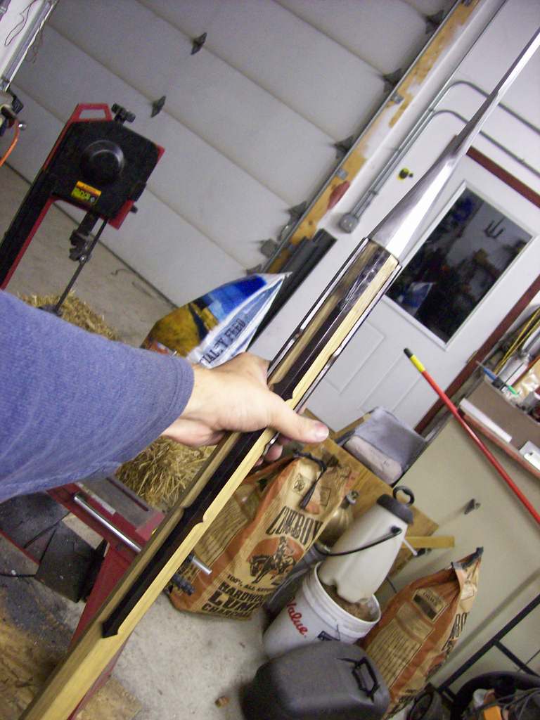

It has been a long day but I wanted to post a few shots of the spear, and proposed languetts. The spear is ready for final surface finishing (shape and lines are done), and the languetts (if Jean likes them) need to be cleaned up and recessed into the haft, then it is just make and add the nails and pins.
By the way, Jean, if you don't mind me asking, how tall are you? I am 6'1" and the point of the lugs are an inch or so above my eye, kind of made me start thinking of being very safe and careful!

Thanks for the kind words guys! I am looking at the spear right now and one thing that I am thinking about is if the edge languetts are too long compared to the flats... I can grind off the top set of points and move the edge languetts up so that they extend 3 inches below the other set, instead of the 8 inches they are now. I think in regard to function there will be no loss, but I think if they are longer they can act as a orientation guide for the hand.
Your thoughts?

| Michael Pikula wrote: | Thanks for the kind words guys! I am looking at the spear right now and one thing that I am thinking about is if the edge languetts are too long compared to the flats... I can grind off the top set of points and move the edge languetts up so that they extend 3 inches below the other set, instead of the 8 inches they are now. I think in regard to function there will be no loss, but I think if they are longer they can act as a orientation guide for the hand.
Your thoughts? |
The languettes look fine as they are now and I like the idea that they give information about blade orientation.
( Longer also protects more of the shaft from cuts and I like the contrast with the alternating shorter languettes ).
Oh, I'm 5' 9" so the points of the lugs should be higher than eye level.
Had a look at the pics in the previous post and I'm seriously pleased and impressed.
The details of the languettes is one of those nice surprises I was talking about in previous posts and why it's a good thing I didn't micromanage the fine details while at the same time the things I liked best about the original I based my design on are all there and even " better ".
The only thing I haven't seen yet is the butt plate that should function mostly as a protection to the wood of the haft at the butt and also to be able to strike. A bit of weight to it also to act as a counterweight to the head but should not be too massive either.
I agree with Scott that it has a really intimidating presence as well as " killer " aesthetics.
