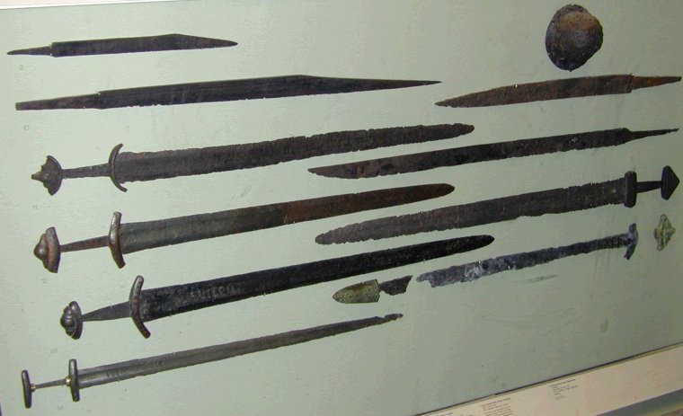

Here is another pic of Viking and Saxon lansaxes (along with a few swords). These no longer have their hilts, but they would have had full hilts.

Jeremiah Swanger
Usergroups: None
Location: Hershey, PA
Joined: 20 Feb 2004
No reading list
Posts: 445
PostPosted: Sun 22 Feb, 2004 8:40 am    Post subject: Ooh... Reply with quote
There's one pattern in there that I haven't seen anyone take a crack at- the one on the right side, second from the top, with a somewhat rounded tip- almost like a 'proto-backsword'!
Thanks for the info, Jay. That cleared a few things up for me.

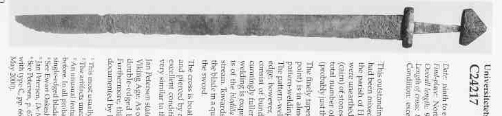

This post got me thinking, and as a suitable Sramasax blade was sitting in the shop, I set about to make a 'historically plausible' hilt for it. There is a metal shoulder band around the hardwood hilt, and the tang passes entierly through the hilt, through a metal plate and then through a migration-era style pommel. The tang is then riveted over the pommel. The wood handle was relieved to accomodate the thickness of the linen cord wrap and the leather covering that, and also so that the shoulder band and supporting wood would form a rudimentary guard. For reference the blade is 17-3/4 inches long and the overall length is 23-1/2 inches. Information/inspiration for this came partly from information and photos in this post, partly from a 'continental-style' saex pictured in Harold Peterson's 'Daggers and Fighting Knives of the Western World' and partly from general information on period hilt construction gleaned over the years from sources too numerous to mention. Lighting conditions sucked, which did nothing for my already questionable photography...

Here is a closer look at the hilt-

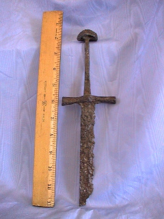

I have just recently started following this discussion regarding the seax. I hope that the following is found to be useful, although it may turn out to be a red herring. I have the fragment of a single edged weapon, represented at one time as a 9th or 10th centuary dagger or child's sword, however I am looking in to the possibility that it is a seax. It has a small "tea-cosy" pommel (about 1.25 inches wide, 1 inch deep and .75 inches tall), a 3.5 inch long grip area/tang and a 3 inch wide lower guard. The hilt area is about 4.75 inches in total length. What remains of the blade is about 7/8 inch wide and 6 inches long, although I can see it was longer originally since the end is clearly broken and the ridge on the non-edged side of the blade extends all the way to the tip.
I am looking into the possibility that it could be a seax because of the single edged blade, the width of the blade, and the fact that the grip area is long enough to accomodate a man's hand. On the other hand, it does have a guard, tang and pommel that do not match my previous conception of a seax.
In answer to Jay's most recent question -- assuming the the blade on this piece wasn't much longer than six inches, the distal taper appears to be about that typically seen with a single edged sword ... but take that with a grain of salt since I have no idea of whether this is a seax in the first place!
If it isn't viewed as hi-jacking Jay's topic, I would welcome any and all comments as to what this piece was and how old it could be.
