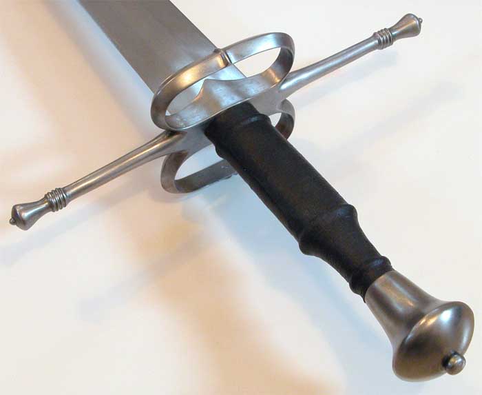

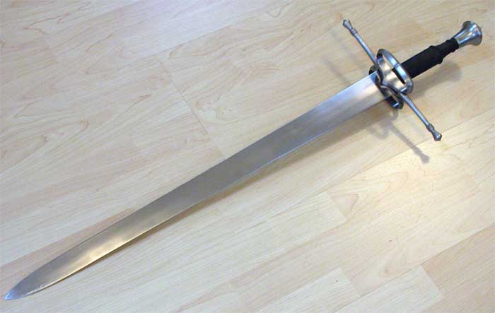

I wanted to post a few quick photos of my last project before submerging in preparation for my family's own private "Labor Day".
Dustin Reagan had the same idea, with very nice results:
http://www.myArmoury.com/talk/viewtopic.php?t...light=cord

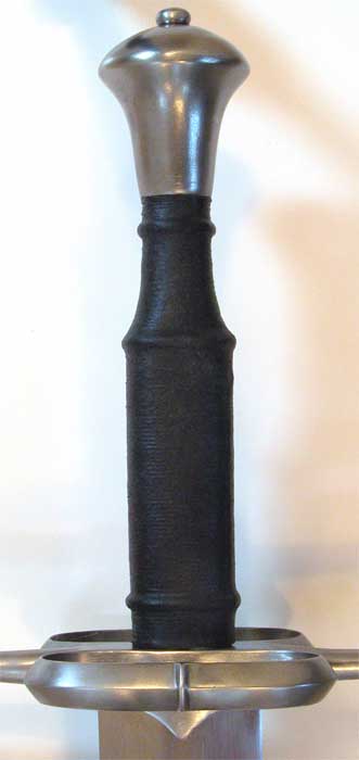

I went a slightly different route with mine. I discarded the entire grip, which was just a dowel with two facets cut into the lower end. The new grip is oval in section, like the original's (see last photo below). I narrowed the base of the pommel, filed off the raised part of the pommel below the nut and flattened the quillon block to conform more to the design of the original. I gave the hilt and blade a satin finish, firmly wedged the cross in place, used JB Weld on cross, grip and pommel, and peened the tang over the pommel nut. The sword feels and looks much better to me. The first photo shows the piece as purchased.
I didn't set out to match the original exactly. I just wanted something with a nicer finish and a few more historically appropriate details.
 Attachment: 82.99 KB
 Attachment: 57.77 KB
 Attachment: 46.63 KB
 Attachment: 57.09 KB
 Attachment: 49.48 KB

Excellent! I've always liked the look of this model, but your modification is a huge step up.
Since I'm here, how flexible is the blade? This model is a tad newer than any MRL longswords I've handled, and they were all noodles...

The thing about this blade is that although it clearly is not enough like the original to be considered a reproduction (the fuller is non-negotiable, in my view,) it seems to be a reasonable form for the period, culture and hilt. That's one reason I consider this piece to be more generally "in the style of" the early 16th c. rather than a reproduction of the Wallace Collection original.
Specifically, the blade is of thick and pronounced hexagonal section in its upper third, gradually tapering toward the point and becoming lenticular. It's a broad, strong cutting blade, which is true to the type and period. It's also the stiffest Windlass blade I've ever encountered. That may sound like faint praise, but it really is extremely stiff. POB remains ~3" below the cross in spite of all my hilt work because I also sharpened the blade.
I share the frustration with some Windlass pieces, wondering why the designers would go out of their way to get something wrong, giving one sword an ahistorical blade when we know the company is technically capable of getting it right on other swords in the same price range. This piece is one of the good ones, and although I would prefer a blade more like that of the original, this one is a reasonable substitute (especially for under $200).
Looks great!
Have a few questions:
-What sort of leather did you use, and where did you find it?
-how did you manage to file off the little raised part of the pommel?

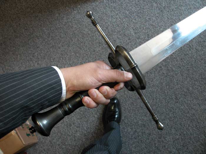

Also, can't help but notice...are you a lefty as well? =]
Dustin
PostPosted: Thu 26 Jul, 2007 2:07 pm    Post subject: Re: Another German Bastard Sword Upgrade         Reply with quote
-I'm cheap. I use chamois from the automotive section of Mal-Wart, etc. You can get lots of grip wraps out of a $13 chamois. Big Grin There are variations in thickness within a given chamois, so you have to be mindful of that when marking the pattern. Also, there's a subtle difference to the inside and outside, with a smoother surface outside that's difficult to distinguish when the leather is wetted just prior to wrapping. The shoe polish, ren wax and buffing gives the surface a glossy finish, but it can dull over time without re-buffing.
-For the filing, I just clamped the pommel in my bench vise and started filing. It's relatively soft metal, and the whole process took only a few minutes. You have to disassemble the sword to do this, of course, but that's just a matter of unscrewing the pommel nut (TIP: don't hold the sword grip, blade down, and remove the nut. Otherwise the blade will just drop right out of grip and guard and damage either your foot or the tip of the blade, if not both). Use a bench vise or keep the sword horizontal on a flat surface as you disassemble it. You can both loosen and tighten the nut by turning the entire pommel, by the way, as long as the nut is hand-tight against the pommel.
–I'm a righty. I needed my right hand free to hold the camera, one of the most notoriously annoying technologies for lefties--that and maybe the bolt-action rifle. Big Grin

Thanks for the kind words, folks! The work is rewarding in a variety of ways, but it's always good to hear what others think, too.
By the way, the cord I used for both the underwrap and temporary overwrap was just neon-orange cotton cord from Lowe's. The orange grip, pre-leather, actually looked very cool. Cool The risers are hemp.

Sorry if this is a truly dumb question, but how did you remove the colour of the cross and take it back to satin finsh? What method did you use and how would a person go about it?
J. Pav
Location: NJ
Joined: 05 Oct 2006
Posts: 75
PostPosted: Wed 12 Sep, 2007 3:20 am    Post subject:         Reply with quote
I'd suggest a good long rubbing with medium, then fine scotch-brite pads.
For a shinier finish, continue with sandpaper, getting finer and finer until atleast 1000 grit.
