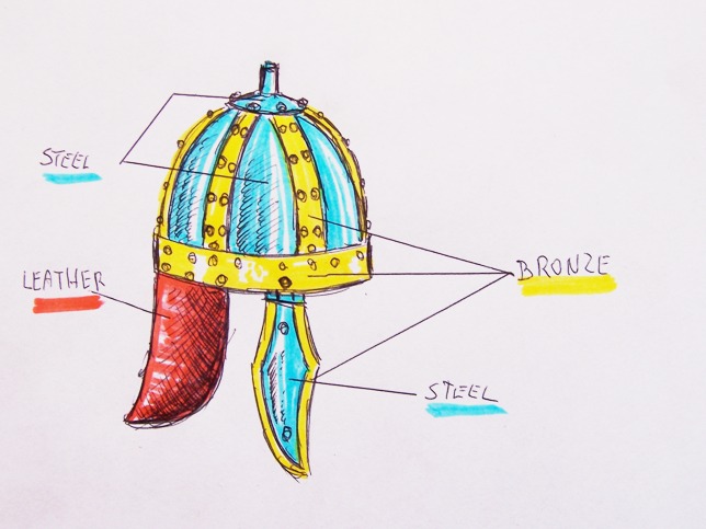

Hello everybody!
I am making now two archer's helmets, based on Trajan's Column (you can see some pictures below) and I have some doubts... . I haven't seen so far any find of it, only some similar helmets (for ex. baldenheim type).
I want to make them this way :
The bowl of the helmet - construction very similar to spangenhelms from Vth-VIth cent., but with narrow ribs, as on Column.
One helmet will have the bowl made of six pieces, second- of eight pieces - as customer wished.
Every rib riveted to the bowl on 4 pairs of rivets.
There is going to be cheeks protection suspended on hinges to the banding

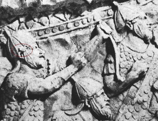

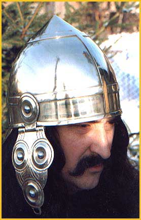

And now my biggest problem : how to make those hinges. Question I can see something on pictures - it looks like the hinges are mounted outside the helmet, but regarding to Roman helmets, I think they should be mounted inside. Then again - those are Hamian archer's (Syrian) , as I was told, so maybe their helmets were different Confused Then again - still it was auxilias (I am not sure if this is correct in English) Exclamation I am really confused.

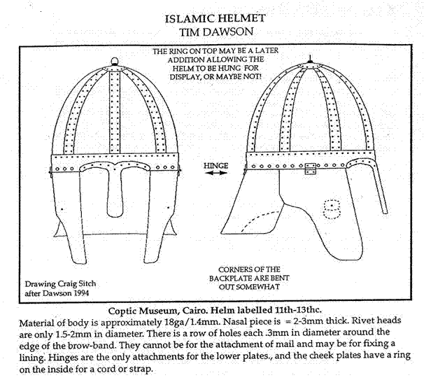

My second doubt is neck protection : it looks like it would be made of some kind of flexible material - leather, I suppose. But I know one XIIth - XIIIth cent. helmet from Cairo museum, which has neck protection made of steel. Yes, I know that it is much later, but I started to think about it, when I saw it.
What do you think about this case? Maybe you have some helpful photos? I would be appreciate for any help.

hinges marked on red

I have made my decision - I will make the hinges mounted inside. Also, I gave some suggest to my customer and now just have to wait for answer.

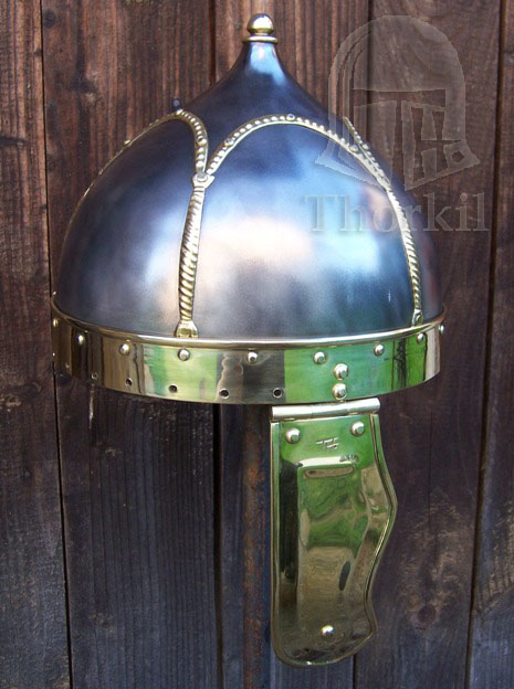

PostPosted: Thu 16 Aug, 2007 8:23 am    Post subject: Photos of Hamian Archer's helmets made by Thorkil         Reply with quote
Hello. Finally I have some time to put here promised photos. Sorry that you had to wait so long.

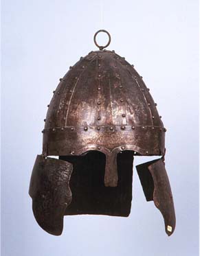

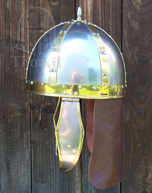

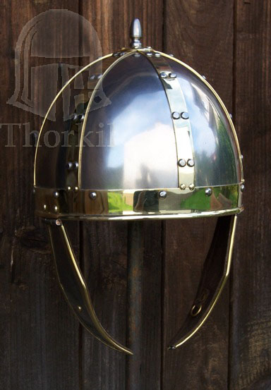

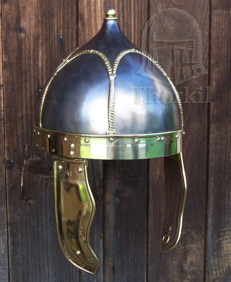

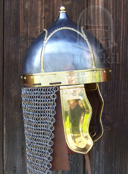

Those are two different helmets : one is made based on Trajan's Column (I have already attacht photo of thesehelmets in my first post) and second is similar to Bryastovets helmet. Yes, unfortunately, this is not replica, it is only similar helmet, because our customer couldn’t afford higher price of making replica of it. But I hope, one day I will have opportunity to replicate Bryastovets helmet.
I wanted to put the scale as a neck guard, but one customer wanted only thin leather and second preferred chainmail and I always listen to my customer's wishes.
First, few informations and links I found about Hamian archer's helmets, other that I posted here before.
http://www.romanarmy.net/hamians.htm (a very interesting article)
[quote]“In both cases the soldier is wearing what appears to be a conical helmet. The Trajan's Column soldier is seen in profile and both cheek guards and neck guard can be seen. There are two helmet examples which could be classified as archers' helmets. One (in the museum at Sofia) is particularly heavily decorated with depictions of Roman Gods and Goddesses, the other from the other from the Dakovo region of Bosnia, quite plain except for its applied beaded wire decoration. Both helmets have holes in the nape of the neck for the attachment of a neck guard, possibly of mail or scale.”
[code]

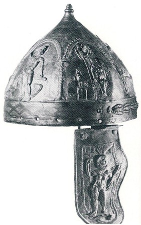

Below you can see the photo of helmet from Sofia museum - helmet from Bryastovets.
And here is small citation from H. Russell Robinson's - 'The Armour of Imperial Rome' :
"The Syrian bowman depicted on the Trajan Column probably provide a fairly accurate picture of the cohortes sagittariorum - auxilliaries specifically recruited from peoples, skilled in the use of the bow. Their helmets are conical in the skull, with neck-guard and cheek-pieces in the Roman manner. The conical skulls vary in detail - some skulls fluted, some reinforced in a manner similar to legionary helmets, and others apparently built up from large segments like the later 'spangenhelm'. In some instances these helmets are surmounted by a button situated upon a moulded base".
I am also attaching Peter Connolly's colour illustrations with Bryastovets helmet.
Both, the citation and colour ilustration was found by my another customer and friend, Stuart Quayle. Thank you for that very much, Stuart! Happy
Enjoy and feel free to comment.
Best wishes,
Thorkil.
P.S. Chuck, I still haven't received activation e-mail from romanarmyforum. Sad

Helmet from Trajan Column - my vision of it.
 Attachment: 63.44 KB
 Attachment: 95.26 KB
Helmet similar to Bryastovets helmet - my production.
 Attachment: 88.06 KB
 Attachment: 84.55 KB
