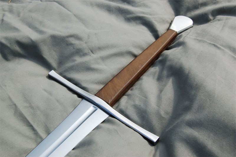

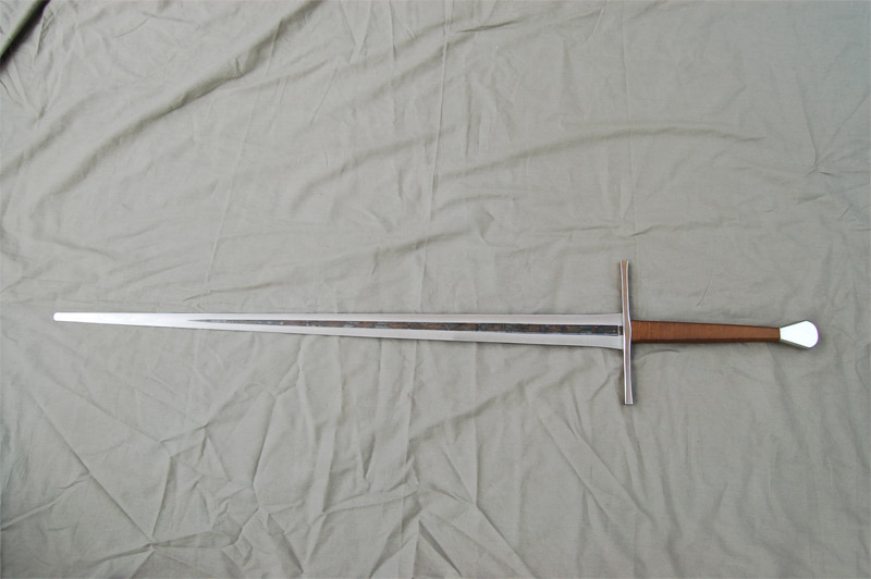

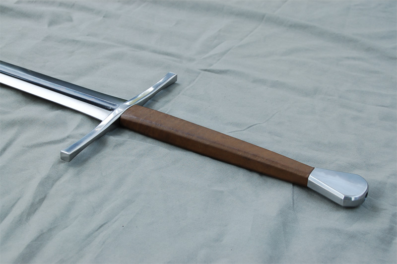

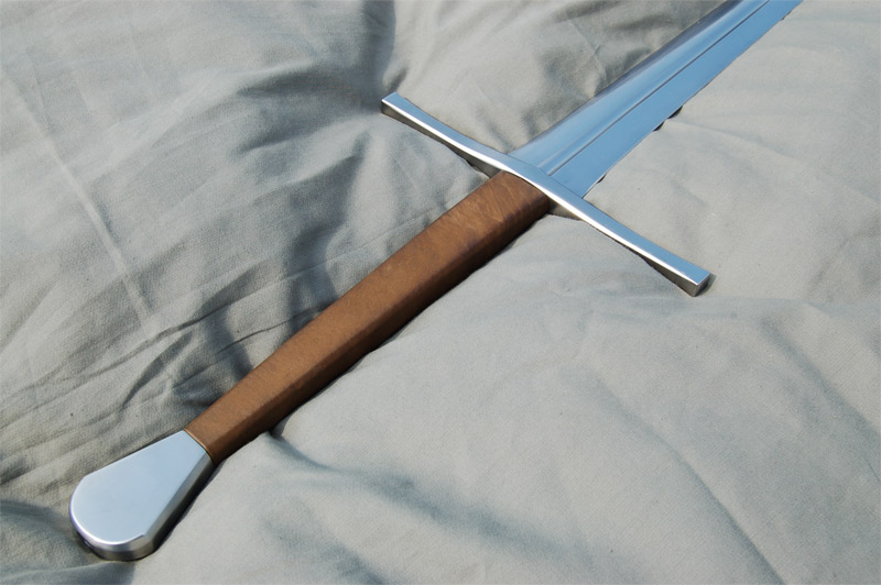

Just unwrapped the protos and snapped a few shots before these make their way to Hanwei. Let me know if you guys want any other angles, etc. They'll be gone tomorrow!

Interesting stuff. I like that Hanwei is adding to their lineup and addressing construction and handling issues (tempering, too?).
I uderstand the reasoning for the fuller ending where it does, though I don't care for the look personally. Happy Not all fullers extended onto the tang; some just went uder the guard. If this fuller could do that a little bit, it would improve the looks a lot for me.
What was your inspiration for the pommel? I've not seen anything quite like it. Is the main face flat or is there some curvature to it? The pics make it look flat in the same plane as the grip.
Also, what's the goal for this product line, especially in regards to historical accuracy in appearance?

Hey Chad, Hopefully Tinker will chime in with his goals as well, but for the most part the goal of this piece is to provide a high quality sparring blunt and cutting sharp with as near identical size and handling characteristics as possible. The sharp should be the more historically accurate of the two with the blunt being modified to match it. The historical accuracy of the sharp is not of primary concern however, the primary concern is performance for the type and solid construction.
These pieces will be tempered to Tinker's specs (nearly every part of the construction, actually). The pommel is basically flat, and actually tapers ever so slightly from the grip to end.
