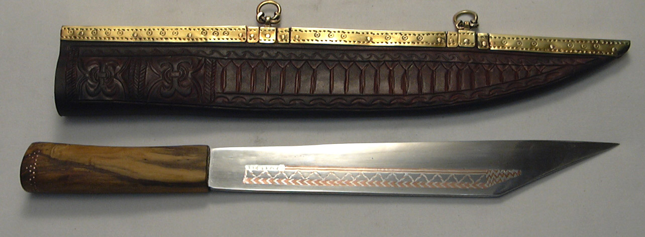

For those who may be interested,
Here is my seax inspired by the honey lane example. I t is my hope that this type of knife would be contemporary to this example. Perhaps it gives a notion as to how some of these beautiful specimen would have looked when new.
Seeing these again gets my wheels turning as to another commission!
Jeremy
I MUST find out what is on the other side of these pieces!!

Thank you for the picture. I think I remember the pictures when you first got this seax, didn't Tod of Tod's Stuff make this for you?
What type of wood is the handle made from and are those pins decorating the butt of the handle?
It is a beautiful piece.

Yes, Tod made this for me- along with Owen Bush who made the blade- and I can't reccommend him enough. It was ordered through Tod- who handled everything. The grip is spalted box wood and is especially striking- and those are copper pins in the end.
Comparing mine and the Honey Lane example you can see significant difference in the blade shapes- so "inspiration" is really the operative work here. But man- now that I have one I realize how neat these things are. My original premise with going for a seax was my desire to have a combat knife that could have possibly been seen in the early middle ages (1000-1100). Many of us are aware of the "hole" in archeological finds relative to knives pre 14th C. and I wanted something that might fit my desire. . .
But now that I have my seax I see the beauty in these specimens- and am not as bothered by what I feel is the inability to have a truly authentic combat knife of the early medieval period. Sometimes we don't know what we are looking for it seems.
Jeremy

I neglected to mention that I'm really impressed with the sheathe too. It has more than a touch of barbarism in it and yet it looks (and I'm sure it is) well crafted.
OK, How does it handle? Does handling your seax give you any insight into the question about the off line haft on the Honey Lane seax?

First of all- it handles fabulously- and like nothing else I can think of. The expanding blade adds a bit of weight to the cutting (chopping) movement. This thing feels scary when brought up to speed. Saying that it in no way has a "bland" feeling of a simple chopping implement and this must be due to the long broken back section and needle like point which add a dynamic feel.
As a absolute seax newbie it is hard for me to speak more abut the specifics but frankly, I can't see the benefit of the off-center tang if it was done on purpose. If it were bent the other way I might be able to- as it would add to the forward inertia. I really don't know the specifics of how a seax like this would be used. I do know that it would be used for chopping motions because that screams out at you when you wield it. Others more familiar with how seaxes were employed would have to educate me. For instance- I do not know if an individual would have employed a dagger like reverse grip at times.
Thinking about the possibly accidently bent or on-purpose- off center tang- due to my ignorance I cannot give a strong opinion. But, frankly I can't see the benefit of this design
But guys I am not an Anglo-saxon warrior- I am an American Social Worker. Many features of historical weapons have designs that seems counter-intuitive to me- and this may be an example of that.
I am not one for theorizing about weapon usage. I like to rest on the research and passion that those with more time than I put into the subject. I like owning and wielding these things. I am not a martial artist or versed in combat of any kind so my opinions would be worth a grain of salt!!
Do others think that a seax like this would have been reversed in the hand? I do feel comfortable stating that the handshake grip seems much more likely than the hammer grip.
