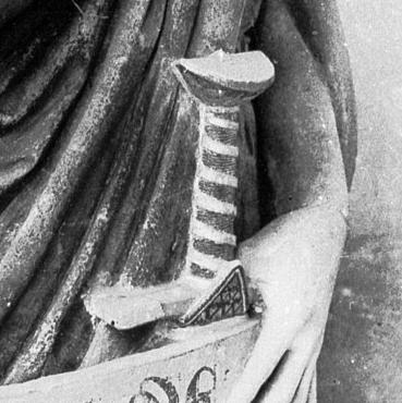

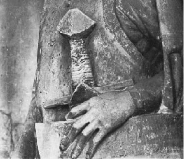

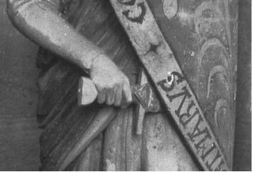

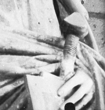

I suppose it is supposed to look like a sword of one of the Naumburg benefactors´ statues?
They have been made between 1250 and 1269, and either show variations of brazil nut pommels or disc shaped variations. The replica apes the general silhouette, but not the three- dimensional shape.
The funny triangular shape on the quillon block originally is an extension of the scabbard leather that in the replica has been made into this funny little step.
The crossguards as such may seem a bit blocky, but the statues are made of sandstone, so require a bit more "meat" to last.
Well, go figure, I attached some detail pictures.

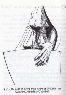

According to Windlass's marketing, this sword's hilt is based on the sword of Wilhelm von Camburg, which is to be seen at the Naumburg Cathedral, apparently as represented in a statue. The hilt of this sword is shown as Figure 107 in The Archaeology of Weapons by Oakeshott (page 226 of the Dover edition) Most of the sword is hidden behind a shield.
The bottom photo submitted by Ivo Malz above seems to be of the same sword, but taken from a slightly different angle than the one from which the drawing was made.
I think the Windlass sword's hilt looks a lot like that in Figure 107, but differs from that of the photo. The little step that Ivo refers to above is shown on the drawing as part of the cross, but doesn't seem to be on the statue.

The sword of Wilhelm von Camburg has a brazil nut pommel, not a flat fishtail. Windlass ought to do their homework or employ someone to do it.
This is Wilhelm von Camburgs original sword.
 Attachment: 30.37 KB

... I think the Windlass sword's hilt looks a lot like that in Figure 107, but differs from that of the photo. The little step that Ivo refers to above is shown on the drawing as part of the cross, but doesn't seem to be on the statue....
I agree with the comments from Alan and Ivo. It looks like Windlass just extrapolated the pommel and cross from Oakeshott's sketch, and that was the limit of their research. I do think that the step in the cross is present in the photo, just not very obvious. I don't mind the way Windlass did the pommel (accurate or not), but the way they executed that cross is really ugly.

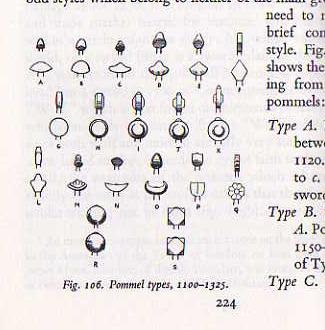

Here´s two pictures, scanned from the Dover edition of Oakeshott´s volume "The Archaeology of Weapons".
The first shows Oakeshott´s classification of pommels, and the pommels in frontal perspective and seen from the side. Wilhelm von Camburg´s swords has a type N pommel, the Windlass "replica" claims to be Oakeshott- based. Go figure.
The second pic shows Oakeshott´s sketch of Herr Wilhelm´s statue. Look at the pommel, and say for yourself- does the "replica" look anything like it? Maybe when looking into the sun.
Okay, the step in the crossguard could be interpreted from the sketch. But isn´t it a poor job of research to go by one sketch only, especially when the sketch was made to stress the type of pommel, while there is a whole chapter dealing with crossguards in the book (starting at page 231 in the Dover edition) that at no point whatsoever mentions this particular feature?
I am sorry, but for a company that claims to base their work on the research of Oakeshott this sword- shaped object is a major disappointment in all aspects. And the claim that they have done worse in the past doesn´t make it better.
