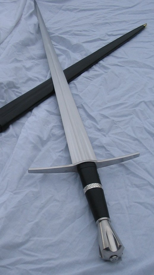

The hot iron is punched through with a tool made for the job,then the iron is drawn out to the desired shape,the punch can be used again later in the job to cleanly open the hole for the tang to pass through,this can then be filed to fit when cool
 Attachment: 49.31 KB
 Attachment: 78.36 KB

yes,the drift will widen the central portion of the bar,maybe adding 1/4",so if you want a fairly thin grip that would be fine i would think.I use a piece of tool steel,hardened and tempered,cut to the rough tang shape and slightly sharpened at the tip,to cut into the hot steel,the shoulders also provide a recess for the blade,so these can likewise be shaped to suit.The example here is for a type XX guard.the centre swells out a bit with the punching,this is cleaned up and filed eventually.
 Attachment: 79.99 KB
