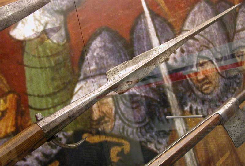

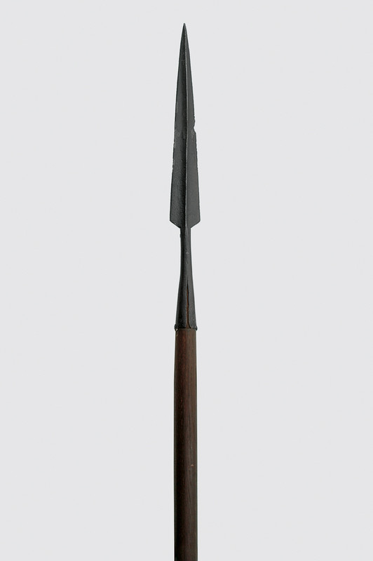

This is the way I haft polearms, and it's the method I've seen on most--maybe even all-- originals of the 15th/16th century. See images below for spears with original hafts or informed reconstructions. Artwork also typically shows flush mounting.
By the way, I use 1.25" diameter poplar dowels for my spear hafts and ordinary bright nails for the rivets (through both walls of the socket, cut off and peened, original head hammered to match the peen. Most (all?) modern spear heads are made like those described above, with ~ a 1 1/8 internal diameter to match the commonly available 1.25" dowels, with allowance for flush mounting.

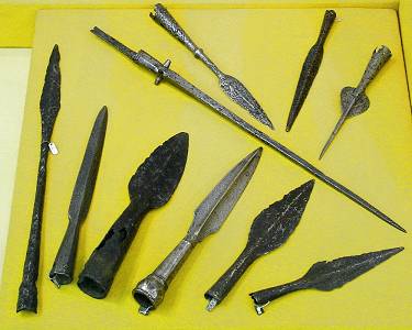

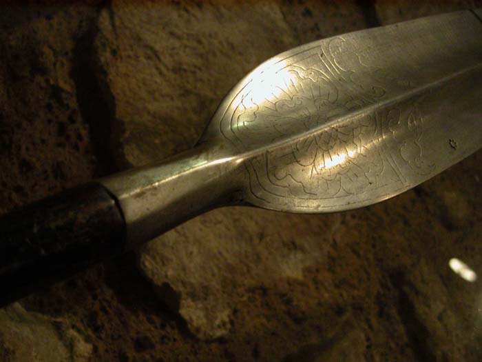

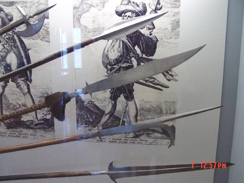

I made some darts/light javelins a few years ago using large medieval swallowtail arrowheads. Instead of mounting the heads on a simple tapered haft, as one would when making arrows in historical fashion, I mounted them flush on tapered and stepped 48", .5" diameter poplar dowels. Given the taper, the haft stepped down from about 3/8" to 5/16". During throwing experiments one of these darts struck a rock and the head snapped off cleanly at the step. I decided that the step serves as a very efficient lever point for the edge of the socket when the head strikes an unyielding object at an angle. I slapped my forehead. Maybe arrowheads were mounted on simple tapered shafts for reasons other than weight savings or simplicity of manufacture. Duh! Lesson learned. I also understood why at least one contemporary writer decried the common use of poplar for arrow shafts instead of superior ash.
Polearms are different (at least in the medieval period for which there is artistic documentation and surviving weapons). Spearheads seem typically to have been flush-mounted with some kind of step, either straight or sloped, thinned edge or not. I hadn't thought of the sloped step solution, but I think that's a compelling idea, albeit one that requires a thin socket edge, which seems counterintuitive for reasons described below. I have little doubt that a straight step puts extra stress on the haft, but I also have little doubt that this matters more in the case of the narrow shafts of arrows. An 1/16" step down on an arrow shaft might prove catastrophic. I'm not yet convinced that a 1/8" step down from a 1.25" spear haft poses significant risk to the haft. I sure would love to get a close look at the sockets of unmounted historical heads now that I know what I would want to look for (a very thin edge quickly sloping up inside to a thick socket wall).
As for thinning the edge of the socket--there might be more danger in this than in a straight step because a too-thin wall could be deformed or torn around the rivet. There is also the case of the spear shown below, which clearly was intended to withstand tremendous stress in the socket walls around its rivet. Now, this is a replacement haft, but one made or at least approved by the Royal Armouries, Leeds. It's flush mounted, with what must be a very thick socket and little, if any, thinned edge.
The other photo below gives some idea of socket wall thickness. The edges of some of these sockets are straight and quite thick, just like most modern repros. We don't know if these were flush mounted, but artistic evidence suggests that they probably were.
Polearms study lags far behind sword study, but that at least leaves us to ponder such interesting technical questions! Big Grin
I think all we can say with certainty is that contemporary artwork and surviving examples show flush mounting. It's also reasonable to assume that flush mounting would not have been the norm if it was known to compromise the weapon.

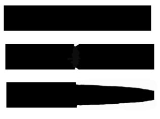

This is a rough diagram of my spearhead mounting method, originally posted in another thread here (the step is exaggerated for clarity). If, instead of presenting this as a how-to diagram, I were to ask, "which of these sticks would be most likely to break?," I think most of us would choose the middle image. I don't know if this perception is true. Somebody else will have to tackle the physics involved, but I'd sure like to know, through both theory and experiment, if a 1/8" step on a 1.25" diameter pole significantly weakens it at that point. I'd also like to hear speculation about why flush mounting seems to have been the common method of construction. Surely it isn't purely aesthetic....? It's a lot more trouble than a simple tapered haft.
 Attachment: 8.74 KB

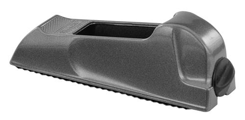

Do yourself a huge favor and pick up a Stanley "Surform" tool at your local home improvement store (you'll want the hand-size model--well under $10). It's a bit like a cheese grater, easily, quickly and evenly tapering the haft, whether or not you use a step. Sanding the haft into shape will take forever and a day.
By notching the shaft to a minimum diameter of 1", you effectively create a 1" diameter rod mounted into your spearhead, and then encased in a 1/8" thick tube over the rest of its length. When you try to flex it, you're flexing a 1" diameter rod, which is significantly less stiff than a 1.25" rod. Given the relatively low ultimate strain of wood, this can drastically increase the chance of snapping the shaft.
The step will act as a stress riser proportionally to how square its internal corner is (i.e. 90 degrees is bad, 179 degrees is good), but unless you actually cut into the shaft deeper than 1/8", it will still be proportionally as strong as a 1" shaft, you'll just be certain to know where the break will be when it happens :-)
As to which of the pictures is worst, the second and third would be the same once a spearhead was mounted onto the third one, as it would more than make up for the lost stiffness of the removed wood.
Sorry I don't have numbers, but I could do a calculation later if anyone wants.

Decreasing the diameter of the haft increases the likelihood of damage. No surprise there. An oak 4x4 would make a much stronger shovel handle than a length of 1" diameter ash. It also would be ridiculously impractical and, in ordinary use, pointless. Ditto for polearms. It's undeniably true that a 1.25" diameter haft is stronger than a 1" haft, but the real questions are whether or not a 1" diameter haft is historically valid and, if so, is it compromised by a step.
If I understand the point made above, a haft stepped down to 1" diameter is not weaker than a simply-tapered 1" diameter haft. It just has a more predictable break point.
I think this is the heart of the concern, and the lesson may be that we're thinking about this in the reverse order of our medieval friends. They may have determined the optimal diameter for a spear shaft and then stepped up, overbuilding slightly and creating a flush surface between socket and haft (for reasons unknown). For our modern purposes, this would mean that a 1 1/8 haft is plenty strong for a spear, and we're not compromising that strength by "adding" 1/8 to create the flush surface. Does that make sense, or am I trying too hard to match the physics to the historical practice?
