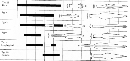

I would advise against taking everything that is mentioned in "Archaeology of weapons" to be true. For once the book is highly outdated and with all due respect to Mr. Oakeshott (whose books i enjoy) the worth of his works lies in the power of his observations and not his scholarly conclussions.
But the sword is indeed of minor importance during the older as well as the younger roman period (roman period roughly from 0 - 400AD).
The main weapons of the germanic tribes has always been the lance or spear. Though comparibly small in comparison at the beginning of the roman period they became considerably larger with time and especially after "meeting" the romans and the roman wy of fighting. But if you take a look at types, like Lynghøjgård (see below), even in the older period lanceheads of considerable size existed. All the shown Lance head types were typical until the marcomannic wars.
The sword was mostly traded into the region, as makers mark show, but that cannot be said for all blades. Especially the traded blades were of minor quality but the Germanics fitted them with lavishly decorated hilts. It was more a symbol of status than a fighting weapon. After meeting the romans the swords became longer and more rapier-like, at least in cross-section.
In the mentioned books you will find more information about this weapons and other, like knifes, axes, shields and armor (when it was worn and its sources).
Taken from the works of Jørgen Ilkjær.
