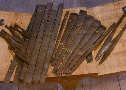

Here is a photo of the splints from one of the graves.
Splints from Vendel

PostPosted: Wed 16 Apr, 2008 2:55 am    Post subject: Reply with quote
I worked at a Bronze age museum for a summer. There I learned about a roman text that descrbied people from what was interpreted as Sweden/Denmark.
They where said to come in their black ships from the north to trade with the romans in germania.
I don´t know any more than that since the archelogist at the musem told it to me. With some searching one could probaly find out wich text he was talking about.
I like those splints. I have heard a theory that they where used on the shins. When you stand in a shieldwall you body is protected but your shins are vulnerable.

Well, OK, if they say so. I have to admit that those things don't look like leg protectors to me. Maybe its seeing them in a photo as opposed to seeing them in fact. Do you think it makes sense that the Vendal period warriors would have such incredible helmets and swords and those sticks as leg protectors? Don't misunderstand I appreciate the information, I just don't think I have enough to visualize it correctly.
The only thing that I have heard of that is even close to this is that there were supposedly Norwegian Vikings who wrapped their lower legs in birch bark before going into battle. They were referred to as Birken something or close to it and NO it isn't Birkenstocks! Even this I take with a huge grain of salt because the reference comes from the name that a Norwegian manufacturer gave to a hunting knife. I found it at a site called Ragweed Forge, his business is selling Scandinavian knives on this side of the Atlantic but he has some links you guys might find interesting.
In some ways I can't decide which is more amazing the actual Vendal helmets or the incredible reproduction helmets that were pictured here.

Ken,
I have seen these reconstructed (or ones like them) as body armour, I think they are greaves not body armour. When I was making my helm, I asked myself the same question, "If they had such amazing helmets, shields and such, why wouldn't they have done the same treatments to splinted defenses." So I made these splinted vambraces to go with my helmet and am planning to make splinted greaves to match.
