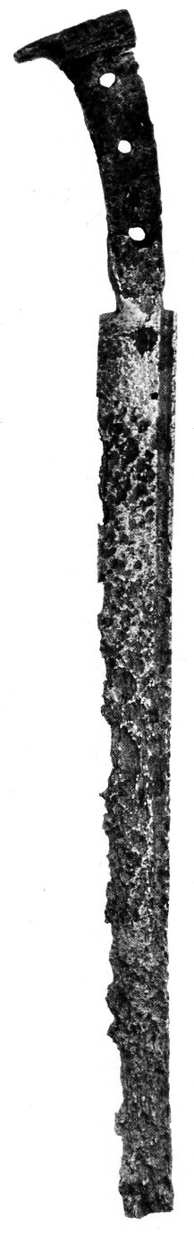

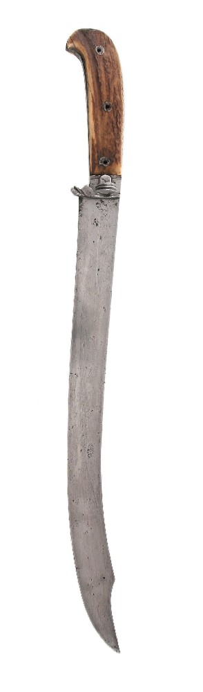

PostPosted: Fri 18 Jul, 2008 7:12 am    Post subject:         Reply with quote
I'd say it's a long peasant knife like the German rugger.
PostPosted: Fri 18 Jul, 2008 7:42 am    Post subject:         Reply with quote
Like these:
 Attachment: 50.62 KB
 Attachment: 51.05 KB
 Attachment: 25.06 KB
