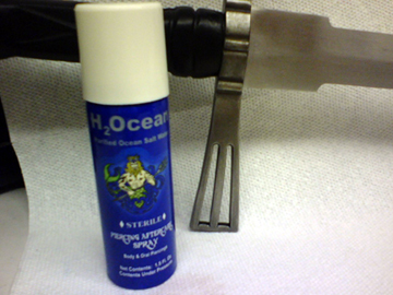

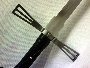

The other day, I discovered something that can put a nice patina on steel without the all-or-nothing approach required by some chemical applications. It’s a body piercing after care product called H2Ocean, and it's a mixture of purified water and sea salt. I applied it to the cross of my "chopped and channeled" Del Tin 5155, and it looks exactly right. Application is as follows:
--Degrease part to be patinated.
--Prep with green Scotchbrite-pad-the mixture tends to bead and roll off unless it has something with “tooth” to catch it.
--Apply H2Ocean liberally to paper towel wrapped around fingertip (or Q-tip for those hard to reach areas) and wipe across part in either a swirling or straight across motion (alternate for best results). If it spots, keep wiping until the spots blend in. After a few applications, the mixture will stay even and wet longer and evaporate uniformly. (It’s best to practice on a piece of scrap steel first).
--Let dry and repeat until the desired depth is achieved. You may have to do this a dozen or more times, but that’s the beauty of the product-the reaction per application is very light and so it’s easy to get the precise depth of color desired. Don’t overdo it, however, or it will start to look artificial (Another good reason to test the process on a piece of scrap steel). A good way to see how far you’ve come is to look at the part against a white wall as it reflects direct sunlight-the diffusion will give you an accurate impression of the color without excess light causing uneven glare. Other options are to look at it outside on an overcast day, or under fluorescent light with a paper towel as a filter. Wipe off the part with water and degrease again, and you’re done!
Note:The first picture is a before shot-
 Attachment: 121.08 KB
 Attachment: 113.14 KB
 Attachment: 143.24 KB
 Attachment: 125.63 KB
