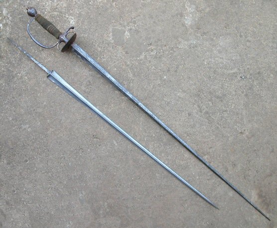

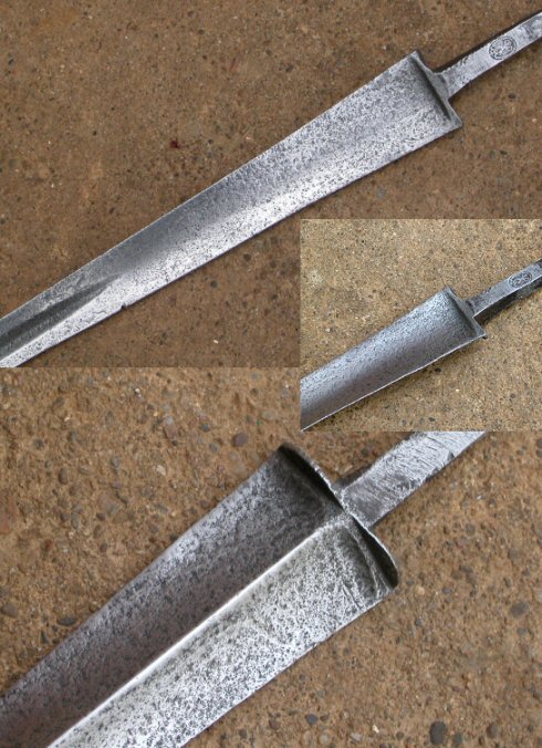

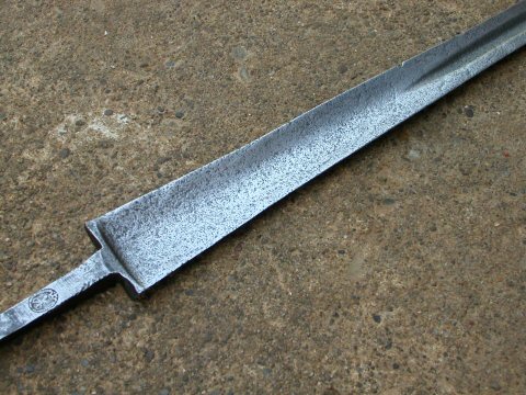

Hi All,
I was wondering if anyone could help me out on this one. My guess would be that this blade is of Solingen manufacture. (but I don't like to "guess" on matters like this Wink)
______________________________________
bare smallsword blade- circa 18th century
blade length- 25 1/16"
blade width- 1 2/16"
tang length- 6 3/4"
(floral etching remains beneath the light overall pitting)
thanks,
Stephen
 Attachment: 82.22 KB
makers stamp on tang "tongue"
 Attachment: 106.97 KB

Steve Fabert
Joined: 03 Mar 2004
Posts: 493
PostPosted: Mon 05 Apr, 2004 1:53 pm    Post subject:         Reply with quote

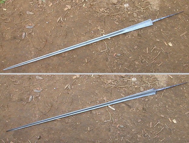

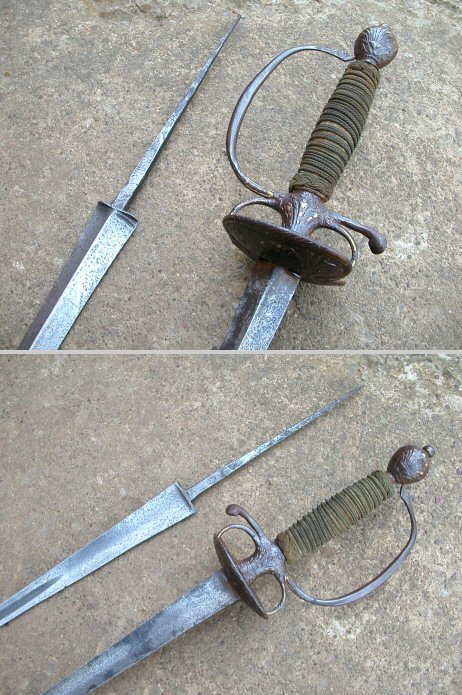

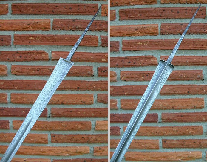

Is that a bayonet blade? I don't believe I have ever seen anything except a bayonet that had so pronounced a ridge on one side only.
Stephen A. Fisher

No, this is a blade for an eighteenth century smallsword. Adult smallsword blades could range from 25-34" (28-32" being the most common) and came in many blade variations: ex. triangular, hexagonal, diamond, flat.
Take a look through the myArmoury.com albums for hundreds of examples.
Smallswords
http://www.myArmoury.com/albums/thumbnails.php?album=55
and my album,
The Smallsword and its variations
http://www.myArmoury.com/albums/thumbnails.php?album=96
The socket bayonet, a French invention from the last half of the 17th century also contained a blade of triangular cross section, very similar to that of the smallsword.

A big thanks to Richard Dellar from the Antique & Military Sword Forum on SFI, he was able to locate the makers mark in the German book, Me Fecit Potzdam: Altpreussisches Blankwaffen des 18 Jahrhunderts ( Prussian Swords of the 18th Century). He mentioned that crossed keys was the trademark of the Solingen cutler Friedrich Herder & Sohn (which still makes knives today). http://www.herder-solingen.de/ He suggested that it could possibly be an early version of the mark.
If one of our German forumites could help out in translating the caption for me, I would be very much obliged. This it what the online translator service deciphered.
"Sign with gekreuzsten keying did not identify in pearl wreath oval on bikonvixer dragoon blade; around 1780"

I am not a native speaker, but it approximates as “Unidentified mark with crossed keys in oval wreath of pearls on double convex dragoon blade - about 1780.”
A similar crown and single key appear on the arms of the city of Bremen. A swordmaker in Bremen may therefore have used such a modified mark.

This is an interesting subject. The symbol of St. Peter is a pair of crossed keys, and the symbol was used widely over Europe throughout the centuries on various seals, heraldry, etc. Many also contained a crown above them. But we can can agree that this blade is of German origin considering the source. The only makers mark that I have found thus far is that of Friedrich Herder & Sohn which features crossed keys. (early 20th century example attached)

The presence of the crown in your first photo is what reminded me of the Bremen arms, and I note that the crown is absent from the more recent Herder mark. The crown was generally used to signify the status of a major city like Bremen. But without some confirmation that there were swordmakers in Bremen in the 1780s, it's just a guess. Since the authors of the book containing the photo of a similar mark were unable to identify it, the rest of us are unlikely to figure it out just by pooling our general knowledge of heraldry.
