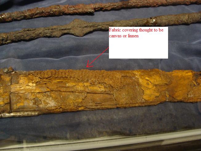

I would like to second the use of velvet. Wool was also used a fair number of times but will probably cost about as much as the leather. linen is a bit cheaper, Canvas is very cheap and looks nice. Most of the sword scabbards in Kingdom of Heaven used canvas which can be purchased at the hardware store they are used as drop cloths by painters so it is very inexpensive, in appearance it is similar to linen and was used on a scabbard I will picture below.
 Attachment: 69.07 KB
