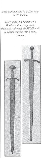

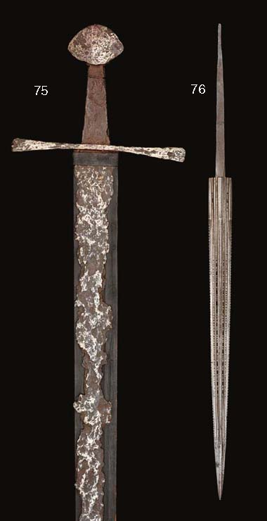

Here's a few more from the period you specified...

Tim, I am especially interested in the sword on the right in the second pic. Is that an Oakeshott type R pommel? Do you have any more info about it?

Scott-
Sorry, no more info about that sword. It is really cool. It looks like a type R to me, but the pic isn't that great. You might try to translate the text. I believe it is Polish...

PostPosted: Mon 16 Apr, 2012 3:10 pm    Post subject:         Reply with quote
No, it's not Polish, it's Croatian, my language. I would love to know where you got this. About the sword on the right it just says it is an Ingelri sword, and that Ingelri was a fankish workshop that produced swords between years 950 and 1000.

PostPosted: Mon 16 Apr, 2012 3:34 pm    Post subject:         Reply with quote
Luka-
I don't recall where I got it. Thanks for the translation. I had thought it said the right sword was from 950 and the left was from 1000. I got the picture because I love the left hand sword with the brazil nut and weird guard. Does it say if the sword on the left is an Ingelrii? Just curious. I wonder if the sword on the right isn't a old blade remounted? If the pommel is a type R and the guard is a style 5 it seems a bit late for an Ingelrii blade from 950...? Weird.

PostPosted: Tue 17 Apr, 2012 3:08 am    Post subject:         Reply with quote
For the left sword it just says that it is from Bordou workshop, I don't know how they concluded that and do they mean "Bordeaux" or what. I agree that the right one is rehilted if it really is Ingelri. But without knowing where the picture is from it's hard to say how accurate anything of this is.

PostPosted: Tue 17 Apr, 2012 9:37 am    Post subject:         Reply with quote
Thanks Luka. I wonder if the left one doesn't have a later cross... Seems a bit too unusual to be original.
