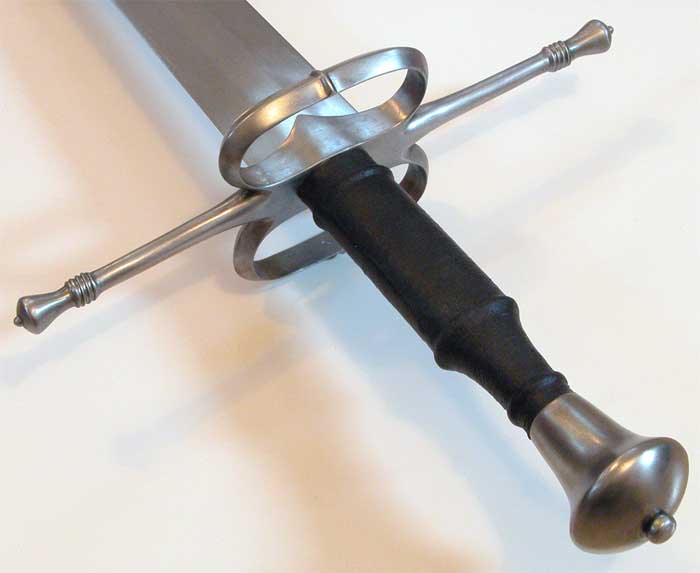

I'd bet it is Windlass, but a later version. They do that sometimes--making significant changes to the piece but still using the original catalog photo. The blade of yours is different (diamond section in lower half) the pommel arrangement is very different and the new finish appears to be some kind of paint rather than bluing. Compare to original finish of mine. In my post-upgrade shots you can see the difference in the blades and pommel attachment (note--I reduced the base of my pommel, peened the tang over the nut, made a new grip and removed the central ridge on the quillon block).

A lot of the things Mr. Flynt touched on... the screw on pommel the painted , not blued fittings.... just small differences... May well be a different generation ...
Mr. Flynt, I like the mods you've done... fine looking piece...

I don't see the Windlass Steelcrafts Hologram nor "Made in India" stamp in your photos, though I remove them from my swords as well (if that is the case with yours). Also, the cross terminates in a much less defined manner than either Sean's or (and more recently) Jon Sarge's. This, to me, seems fairly likely, though not conclusive, that this is a reproduction of the Windlass piece.
JE Sarge
PostPosted: Tue 10 Feb, 2009 6:33 pm    Post subject:         Reply with quote
The last couple Windlass' I owned did not have the Made In India on them, but did have the hologram sticky. The GBS I got a few weeks back (after seeing Sean's) was covered in a thick black lacquer fake patina until I stripped it off and reworked it with steel wool/cold blue to antique it how I liked it. There are some minor differences, but not so many where I would say that they are completely different swords. Windlass is not known for being consistant in many of their products.
The German Bastard Sword is not a really big Windlass seller, so it seems odd that someone would copy it - especially when the same someone could make copies of the Gothic Bastard Sword, Transitional Viking, other really popular MRL swords and rack in some serious sales on these discontinued Windlass models that collectors want.
But stranger things have happened. I'd call and ask them. Might be something odd like they are getting blades from Windlass, they are a Windlass subsidiary (like Strongblade), or some other such arrangement.
Pictures below for comparison (after regrip, stripping, and re-patina)
