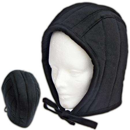

PostPosted: Sat 08 Feb, 2014 11:36 am    Post subject:         Reply with quote
This is what I'm talking about. Ignoring the fact that they are badly tailored and made for questionable materials and methods, its the while concept of such garments in the 15th cent that piques my interest.
There is a preponderance of these things in UK WOTR impressions and I'd love to be able to see evidence of such past the mid 14th.
I sometimes wear a plain coif for the sweat issue but inside a helmet they can slip. That's a pain in a locked up armet on a horse so I pay more attention to the integral liner.
