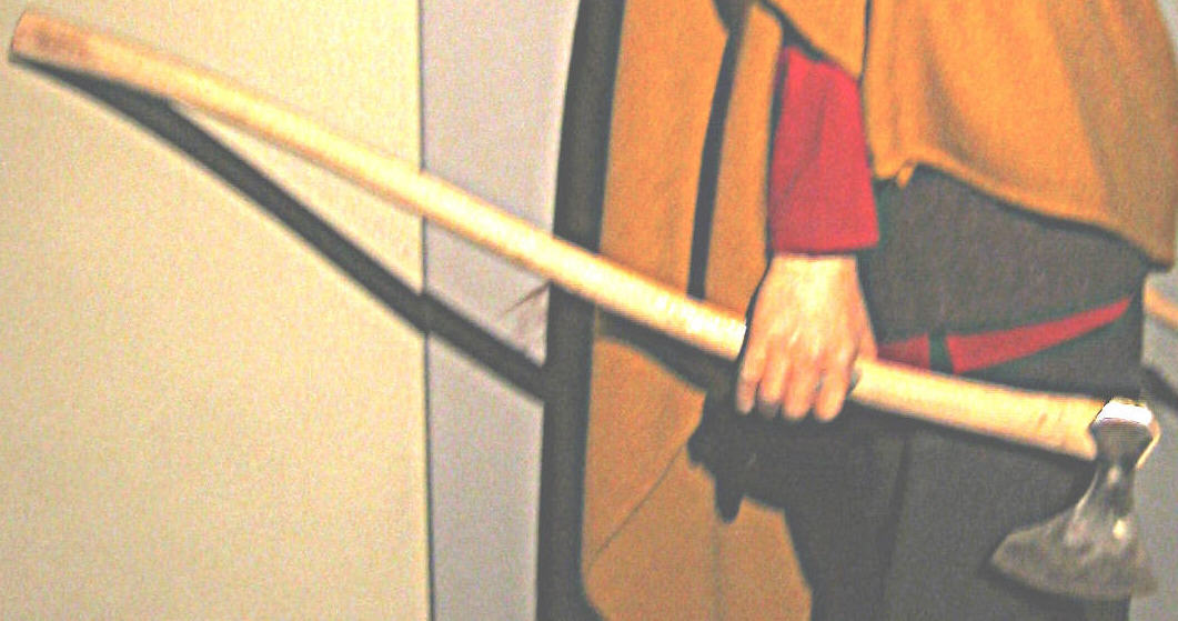

I'd like to throw in a question as well. The museum had a recreation of a Viking Axe (photo below)-- it was hafted very differently from most offerings I have seen on retailers' websites, and I am wondering as to the historicity of it. Essentially it has a curve to it somewhat like that of a modern wood-cutting axe, rather than a straight haft. Any comments would be appreciated.

Yes, these viking swords can be striking in their prescence... You often hear viking swords were sort of shortish in the blade and smaller than the swords of later periods, but to me most seems rather large even if the blade lenght is somewhat shorter than some swords from the high middle ages.
The axe in the photo seems a bit odd to me. It would be interesting to learn what they used as basis for that reconstruction. Perhaps it is some practical testing from reenactment fighting?
Still, it seems dubious...
It is extremely rare to find a preserved axehaft from the viking period.
I have seen one or two. No curvature.
All depictions in art from the period I know of shows more or less long hafts that are always straight.
-Anyone else with other information?
There is now commercially available a "reconstruction" of a viking period handaxe that is used by campers and woodcarvers alike and this axe is mounted on a very curvacious haft. I think the idea behind this is a result of modern testing, and not any archaeological find. I may be wrong about this...
The axe is very nice and most efficient, both for powerfull chopping and precise cutting. I like this type very much.
In Norway there was in use an axe in military context up till pretty recently. The same axe was also carried by farmers as a badge of status. The haft had a 30 degrees turn just below the head so the edge was turned partly forwards. It looks a bit odd at first, but there might be some advantages:
-The point of gravity is placed closer to the line of the haft.
-The forward corner of the edge becomes almost a spear point (these axe heads are asymmetrical, having their edge inclining downwards at the forward point and pushed forward from the eye of the axe)
-The anlge of the edge might also allow for cutting/slicing, not just a cleaving blow?

David McElrea
Location: Canada
Joined: 26 Nov 2003
Posts: 438
PostPosted: Tue 01 Jun, 2004 11:38 am    Post subject:         Reply with quote
Hi Peter,
Thanks for the input-- I had thought the curvature was a bit unusual. It would be interesting to know who made the decision (and why).
I will add a couple of more pics (hopefully of better quality than the previous one-- I thought I had "shrunk" it enough to fit within the text box, as well...).
