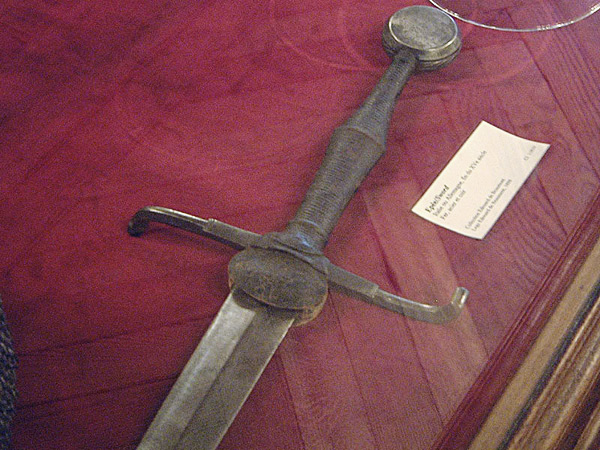

String over leather? Albion Next Generation Grips are simply leather over wood. They wrap cording over the grip while its glue is drying. This not only binds the leather wrap to the wood but also creates the visual pattern of the wound cording and makes it appear that there is a cord underwrap. Many of their Museum Line swords have the cord underwrap, which is more expensive to do because they have to take care to wrap the cord around the grip core, cover the core with glue and leather, then wrap it again with the temporary cord to bind everything together.
Attachment: 126.14 KB
Sword form the Cluny Museum

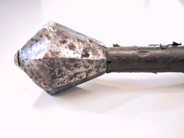

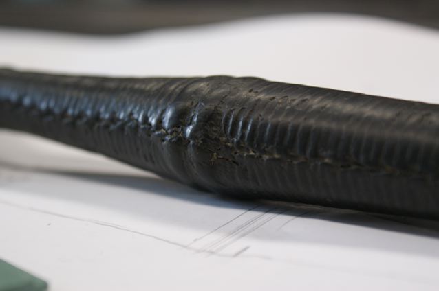

Chad, that is simply not true.
There are many examples of grips with only leather over wood that has cord impression. I have personally documented quite a few.
In those cases where you have embossed decoration it is also more or less standard to have the leather directly over the wood. Risers are built with cord or leather thongs regardless if cord is or is not used under the leather.
The method used at Albion is not intended to mimic something else. it is not a short cut. It is what it is, looking just like some well preserved originals made by this method.
With only cord under leather you get a more subtle effect: the cord is visible as slightly irregular ridges. Depending on the thickness of the leather you will see traces of the cord pattern, or just the ridges caused by the binding.
EDIT:
attached an example (pretty famous one) of cord impression in leather with no cord binding underneath.
Plus and example of a grip with cord binding over wood, under leather but no cord over-wrap. Note the subtle effect of the slight ridging of the cord showing through the leather.

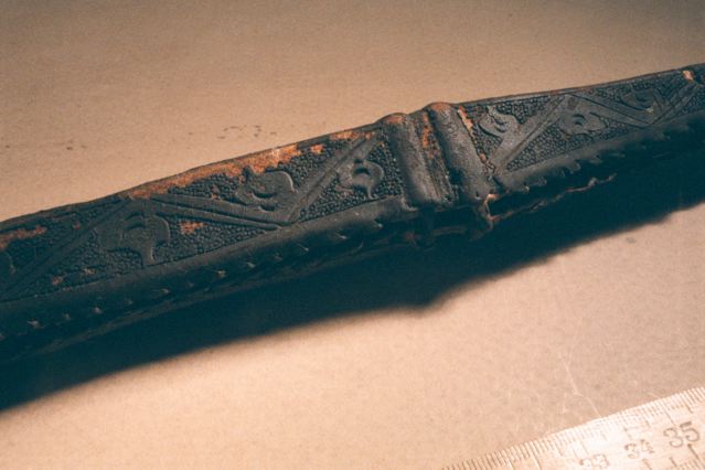

And below, an example of a deocrated leather grip. You can see the seam split apart from the leather shrinking over the centuries, letting us have a view of the wood core (4 part construction) with leather thongs as risers. Note the lack of cord under wrap.
And finally two examples of grips that probably feature spiral wound cord (wrapped with a gap between the turns) and an over wrap used to compress the leather in the gap between the turns below. This is the same method used to create the effect on the Svante Nilsson Sture sword, that is implemented in exactly same way on the Albion version.

Wonderfully detailed grips pictures!
You've certainly made your point Peter.
I'm intrigued by grip wraps using both stitching and yet bear cord overwrap marks.
Also I especially like the shot of the tooled grip as those are obviously rare on the reproduction market (if there are at all, as I recall seeing such work by you and Bartha mainly).

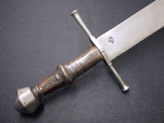

Is this grip the one you used as an inspiration for that sword below? Would you by any chance have pictures of other tooled grip such as this one?
Julien M
Attachment: 31.84 KB
