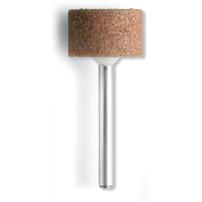

I've used the aluminum oxide Dremel grinding bits to reshape Windlass pommels and crosses. They worked well for me. Faster than a file, but not so fast that it can get away from you. They come in different shapes and sizes (see link below). The ones I think you'd want are cylindrical, and in 1/8", 3/8" and 5/8" sizes. You could also use a round file, either primarily or as a later step in finishing.
http://www.dremel.com/en-us/AttachmentsAndAcc...inum+Oxide

I did try that dremel attachment a couple of days ago...I simply didn't try hard enough...
Just gave another try with it and got the motion right as well as the right amount of pressure...and it does swallow quiet a lot of material. I know now that I can achieve my project with it, then finish by hand with a file then sandpaper...if all goes well as there is plenty of opportunities to ruin it too Happy
