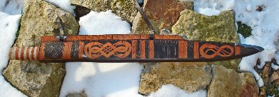

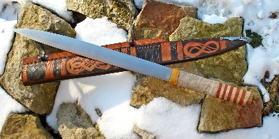

I'd like to show you a few pics of my new sax I got just yesterday. It's a replica of a sax that was found in the grave of a saxon warrior ( Sarstedt burial ground) who was killed in the Süntel battle in 782.
The sax is unusually large and heavy, actually it's nearly as big as a sword.
I'm quite happy with it.

Bartek Strojek
Posted: Tue 16 Mar, 2010 8:33 am Post subject: |
Looks pretty, especially with scabbard!
How long and heavy it approximately is, BTW?

Andreas Becht
Posted: Wed 17 Mar, 2010 2:48 am Post subject: |
The sax is all in all 84cm long, the blade length is 58cm and the weight is approx 2 kilo. Much too heavy for proper fighting.

Peter Johnsson
Posted: Wed 17 Mar, 2010 6:43 am Post subject: |
Size and form is like a rather typical lang sax. The weight is much heavier, however.
It is not uncommon that iron swells as it corrodes. This has been known to have a misleading effect on the interpretation of thickness and weight of ancient weapons. What is the reason for the interpretation of the weight in this case?
As the size and form is pretty typical for a lang sax, is there any other elements that would suggest that this weapon was out of the ordinary?
It would be very interesting to learn more about the original find.
Your sax looks very nice, by the way!
Who made it? It looks like good work.

Mikko Kuusirati
Posted: Sat 06 Apr, 2013 3:44 am Post subject: |
Rise, thread! By the power invested in me as the new owner of this seax, I resurrect thee!
Having just taken some measurements, the seax on its own weighs 1520g; I didn't weigh the sheath but wouldn't be surprised if it's just about another half a kilo, so the seax and sheath together likely weigh in at right around 2kg. The thickness of the blade varies somewhat non-linearly from 9.65mm to 8.7mm, until the final taper into the point along the last third of its length.
I actually don't think it's necessarily unsuited for fighting. Sure, it's very heavy, but based on a few days of dry handling I'd say it moves passably well even with my mediocre at best strength, and for a particularly brawny man with large hands it should be a very effective shield (mail, helmet, skull, whatever) splitter. For me personally, it almost feels like a hand-and-a-half weapon of sorts, especially with the very bokken-like ovoid cross-section of the handle that kinda makes me want to grip it like a katana...

Mikko Kuusirati
Posted: Tue 09 Apr, 2013 5:50 am Post subject: |
Here we go!
Sax weight: 1520g
Sheath weight: 490g (Ha! Am I good or what? )
Overall length: 84cm
Grip length: 25.5cm
Grip width: core 4.1cm, riser and bolster 4.5cm
Grip thickness: core 2.6cm, riser and bolster 3cm
Blade length: 58.5cm
Blade width: 4.3cm at shoulders, 4.7cm at widest point (32cm from grip)
Blade thickness: 8.8mm at base, 9.65mm at thickest point (23cm from grip)
Center of gravity: 15.5cm from grip
The grip is made up of two halves, glued and wrapped with a spiral of what I guess is linen cloth? Andreas might know for sure. There's a 2cm wide leather bolster to reinforce the bottom end of the grip and give a tactile warning before your hand slips onto the blade, glued and pinned in place, and a single riser of what I would guess is the same leather under the cloth, 11cm from the bolster. The riser also serves to seat the sax very snugly in its sheath.
And here's photos! Do note, these were taken in pretty harsh daylight, which is good for capturing textures and small details but also makes especially the sheath look much more worn that it actually is. There's patina on the blade (I tried to capture it in a couple of pictures) and wear on the furniture, but in person they're much subtler and more attractive than it looks here, just enough to give the impression of a working weapon rather than a sheltered showpiece. On the whole, it's not perfect by any measure, but the imperfections are largely cosmetic and this is definitely one case where I think the flaws merely add character. It's a very charismatic piece.

Mikko Kuusirati
Posted: Tue 09 Apr, 2013 5:51 am Post subject: |
And now, the naked beast itself:
