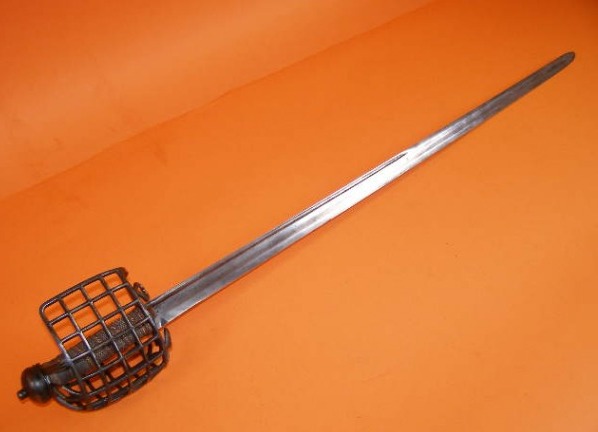

A few from RA-Leeds:
 Attachment: 15.08 KB
 Attachment: 16.97 KB
 Attachment: 14.07 KB

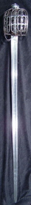

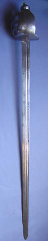

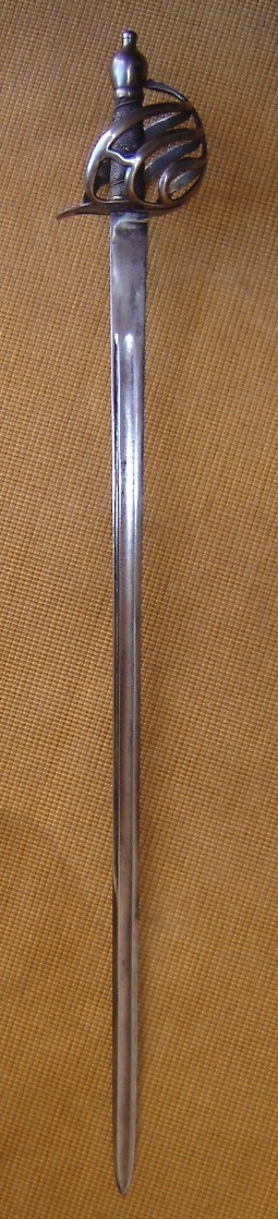

Here are some 18th c British Baskethilted backswords in full length - I am assuming by British you mean not Scottish?
 Attachment: 16.21 KB
 Attachment: 32.52 KB
 Attachment: 69.31 KB
 Attachment: 112.24 KB

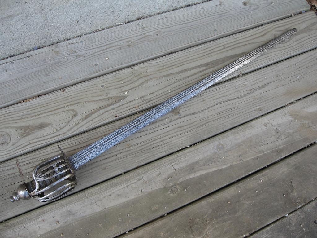

I'm not sure if this is a backsword, but it is an English basket.
 Attachment: 95.46 KB
