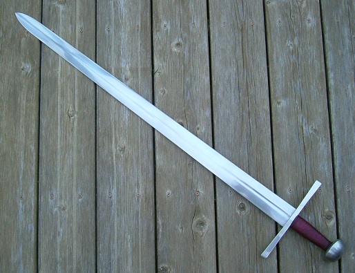

Yee-hah, its raining Brazil nuts in Canada. Look what just arrived in my mail! Thanks again Dan, your work definitely makes the whole greater than the sum of the parts. The grip work is right on par with Albion. It's too sunny today for outdoor shots, but here are a few indoor pictures:
[Edit: here are some better photos]
 Attachment: 99.47 KB

PostPosted: Wed 19 May, 2010 10:07 am    Post subject:         Reply with quote
Love the group shot! Looks good with it's buddies.

Thanks Tim. One more to go, then I'll post the whole family on your thread. You're to blame for this BN obsession!
I just spent half an hour with this sword. The conversion from 1.5 hand to a short grip has pushed the PoB quite down the blade, but overall its quite light for its size and handles very well as long as one sticks to fluid motion. The point control is also surprisingly better than average for cutting swords of this type. I have never had the pleasure of owning an original 'Tinker' blade, but there's something about this one that reminds me of his work.

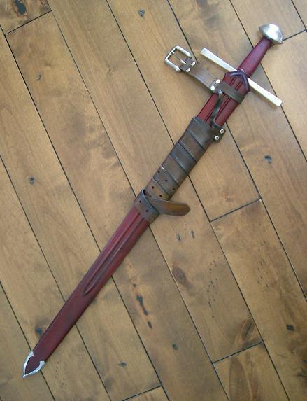

PostPosted: Mon 21 Feb, 2011 8:55 am    Post subject:         Reply with quote
Just to finish this off:
I found a scabbard that fits and matches this sword perfectly (see below). In keeping with the mix-and match theme of this project, it comes from a Valiant Signature sword (the Valiant sword itself will be used for another project). I really like the combo.
In case you are thinking of doing something like this, the whole project (sword parts, Dan's work) + (50% of the Valiant scabbard-sword combination) cost about as much as an entry level Albion next generation sword, not including shipping between several sites and some local taxes.
-JD
 Attachment: 37.61 KB

PostPosted: Mon 21 Feb, 2011 9:28 am    Post subject:         Reply with quote
Looking good JD! Nice match on grip and scabbard color. 1 project down and 1 million to go, right...? Wink
