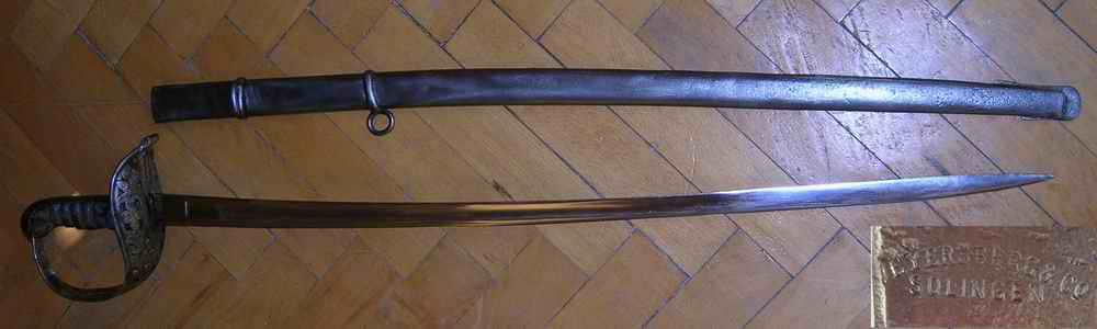

Or maybe I'm wrong. I just checked on of my 19th century cavalry swords and I found out that the lower suspension ring is at the point of balance of the whole thing, 23 cms from the throat. The upper ring is 9,5 cms from the throat.
Well, it's another period, another type of sword that was worn differently, but it's enough to prove that my speculations were incorrect.

Here's my M 1869 cavalry officer's sword... [ Download ]

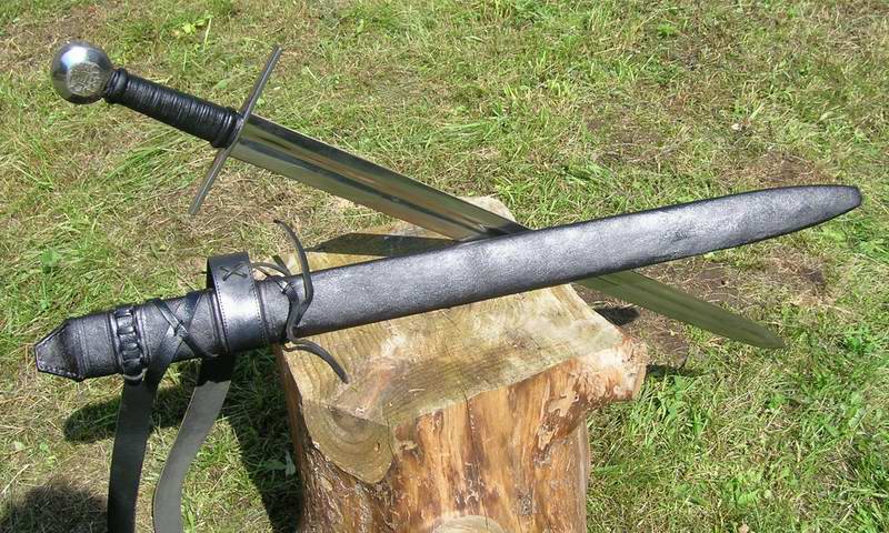

Almost done. Thanks a lot for your suggestions. I have to make a decent chape and some finishing touches on my sword. It wasn't that hard making it, actually it was a very pleasant and relaxing job except for the fitting the pommel part - those damn blisters...

Anyway, you scabbard looks great! Once you get a chape on there, it will look magnificent! Thanks for posting a link to your work! Big Grin
