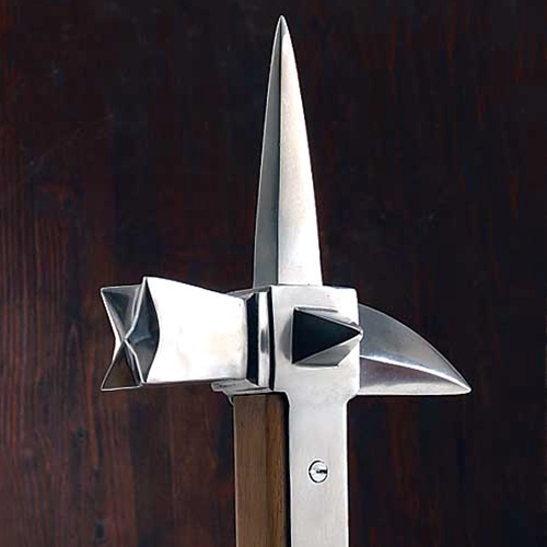

I seem to be starting a pollaxe/streithammer/warhammer project Laughing Out Loud so I'll go ahead and start a thread as well. This piece will be using the Windlass "New War Hammer" I picked up for $62 in MRL's "Deal of the Day" bin. The photos below show approximately what I'm aiming for.
This is an impressive single-hand hammer right out of the box if you can overlook the screws in the langets. I happen to be grateful for those because they make remounting the head on a long haft extremely simple. I tentatively tried to make this work with an old poplar dowel haft I had. That works, but not perfectly. Then I happened to notice that the hardwood handles of my wheelbarrow are exactly the length I want for the finished weapon. A trip to Lowe's yielded a thick 60" chunk of what appears to be ash--perfect for this and other poleaxe projects.
The wheelbarrow replacement handle has a section of approx. 2" square, so you can cut out of it whatever size you need as long as you have access to a table saw or planer (or have a very sharp hand plane and good stamina). I'll rip the piece almost to the right size on a table saw and switch to a hand plane and Surform tool for finishing.
I'll post more as I get into the project in coming weeks....

Sean Flynt wrote:
Then I happened to noticed that the hardwood handles of my wheelbarrow are exactly the length I want for the finished weapon. A trip to Lowe's yielded a thick 60" chunk of what appears to be ash--perfect for this and other poleaxe projects.
Brilliant. I have a polearm head sitting in my shop AND I replaced my wheelbarrow handles this summer, but I never put two and two together. Blush I look forward to your results. Cool
PostPosted: Thu 22 Jul, 2010 10:13 am    Post subject:         Reply with quote
Ha! Things do tend to always work out that way, don't they? At least these things are cheap--$13! They'd be excellent for those GDFB pollaxe heads. The only reason I havn't bought one of those before now was that I didn't have a source for a proper haft.
