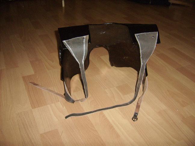

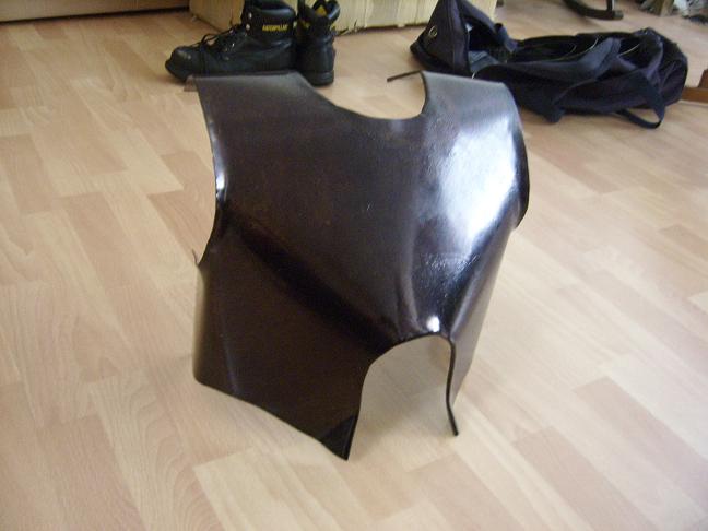

Here's the almost completed breastplate. Literally the only thing I did after taking the photos was wipe off the chalk. It's based off of the St.Maurice painting in the Kelvingrove. Tobias Capwell had a similar (but rather nicer) breastplate a while ago.
I think this isn't bad for a first attempt, but I obviously still have a long way to go.
 Attachment: 71.06 KB
