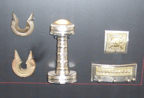

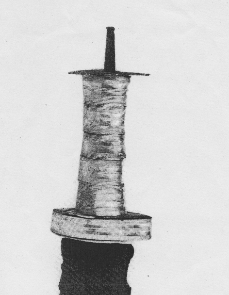

Biborski calls this blade design type Snipstad. It was used in C2, C3 and D1which is 260-400 AD and partly even later into the migration period.
Ususally, this kind of wooden hilt, with the covering of metal sheet (usually silver sheet), which can be found on many swords in Ejsbøl, Nydam and Kragehul, is used either on this kind of blade or on blades of type Nydam-Kragehul.
They normally have a boatshaped pommel like the one below.
Almost all of them were found in Scandinavia. But there are some notable exceptions. One was found in the roman border ford Vechten in the Netherlands and one very ornate example with a silver sheet covered hilt was found in Silistra, Bulgaria in a roman officers tomb.
Typologically, the hiltdesign is similar to the hilt of the Buch-Podlodów blade we discussed earlier. So one could argue that the design is congruent with roman lines of design. The metal covering of the hilt, on the other hand is more usual on germanic swords. Or at least it is mostly found in southern scandinavian bogfinds.
But there is also evidence from many of the more precious pieces in these finds that the craftsmen were probably roman artisans which worked for the germanics.
It is difficult to be sure here.
But the short answer is yes, they were used in the roman army. Maybe also yes, they were designed in Scandinavia, but it is not purely a scandinavian design.
I also need to look into Miks' book again. I only read it once prior to pressing and thats some time ago now. :\
